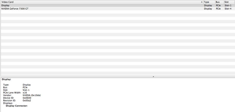

in a test, I installed the G92 8800GTS OEM in the mac pro's X16 slot; the 7300GT was left in the 8X slot as the primary display adapter. I powered the system and surprisingly-- It booted. I received video on the 7300 GT, and immediately went to system profiler. The system had detected the 8800GTS as a "vga device". 🙂
"System Information"
In this photo, you can see the system detected the device ID and vendor ( the information is available in the NVIDIA driver kexts, located in /system/library/extensions/NVDANV50HAL.kext on OS X 10.5.2). I am currently speculating on two possibilities: The newer EFI bootrom revision that is only found on Mac Pros manufactured in late 2007(MP11.005D.B00 instead of MP11.005C.B08), or the new 10.5.2 Nvidia drivers that allowed the system to boot.
