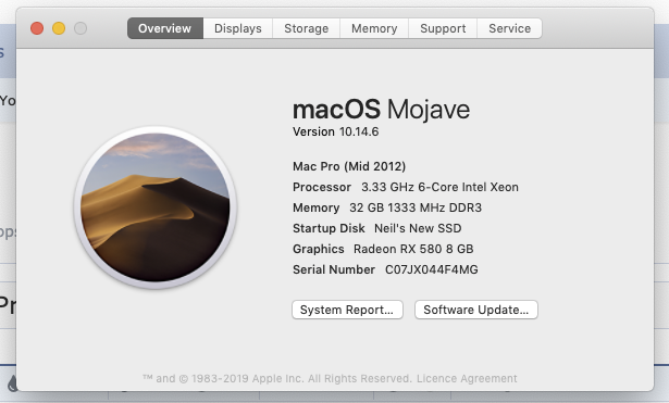

Im going to buy a new Mac Pro to replace my Slooooooooow 2012 Mac Pro old model below;

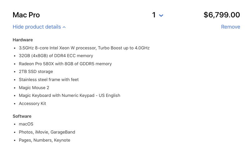

I am thinking of getting the basic Mac Pro and possibly update late using stuff from OWC or similar..............good idea or not?

Unless need all of your data stacked n one big pile or are already at 700+ GB already then 1TB would work too. A drive for your working data could be on another drive that you can increment later. I imagine OWC (and others) will have options lower than Apple's $400/TB rate . Maybe not hugely lower or faster , but optionally can add later.
+1
It’s not certain whether the CPU will be user upgradeable so I would get more cores and base model everything else
+1
sure there's a chance it can't but I REALLY doubt that will be true. They have animations showing it clipped into a standard socket. Under warranty? Different question. Physically replace? almost surely can.
Reactions: fuchsdh
Personally, I'm not a fan of the T2 chip and NAND storage options from Apple. I'd rather roll my own using PCIe risers (Sonnet 4x4 or Highpoint) and add my own NVMe drives. We don't know yet if the x16 PCIe slots are bifurcated or not to allow for cheaper risers like the Asus M.2 card, but they likely won't be bootable.
I'd rather spend money upfront to upgrade to the 12 core for faster memory speeds and faster turbo boost rather than spend $800 on 2GB of SSD.
theoretically the chips are socketed and standard Xeon-W's from Intel. Apple will never endorse the CPU upgrade as user upgradeable, but eventually we'll find someone who will swap the CPU and see if it works.
The machine almost certainly will be able to use the CPUs available as upgrades at some point in the future. Evaluating the usefulness or cost efficiency of that is another topic.
If you're buying the machine now, plan to have it "as-is" with CPU for 2-3 years while under warranty. It would be almost foolish to risk damaging the $6K+ beast for an upgrade. Let some YouTuber test it on theirs first.
I’m actually interested to know if you get 8c basic CPU MP 7,1, the internals especially motherboard, are in no way compromised compared to the specced up version.
It will "only" support half the 1.5TB of RAM that the highest spec model will. That's only due to limitation of that CPU though and would go to 1.5TB if you later swap the CPU to a "-M" variant. It will use a slower spec of RAM too (also remedied by swapping out components). Otherwise there's nothing we've seen to indicate the base is any different that the highest spec in terms of potential.
I have more-or-less the same config, so I'll be interested in seeing the real-world speed improvements of the 7,1. I unfortunately think I'm stuck in the same twilight zone as the 6,1—I'd see a speed improvement but it's not really worth the dollar price with my current work needs.
I definitely think the processor will be upgradeable down the line, but like others say I wouldn't touch it until the warranty had run out, so if you're fine with 8 cores then stick with it. I'd just keep the SSD at 1TB since that's an extremely usable size (I don't quite fill up my 512GB, and in the past I've survived on 256GB) but it'll be much cheaper to fill the machine up with SATA or PCIe flash via an add-on card. Plus if you leave off that upgrade you're essentially paying yourself ahead for a 64GB RAM purchase or similar aftermarket upgrade.
