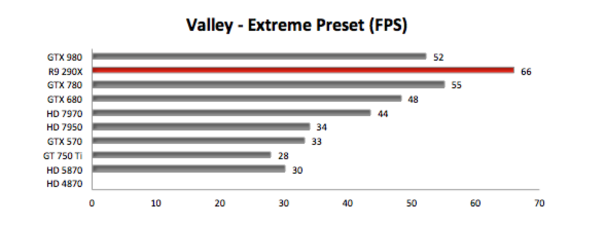

Barefeats.com got 52 FPS with a GTX 980 in Valley using a 6 core 3.33GHz Mac Pro 5,1:

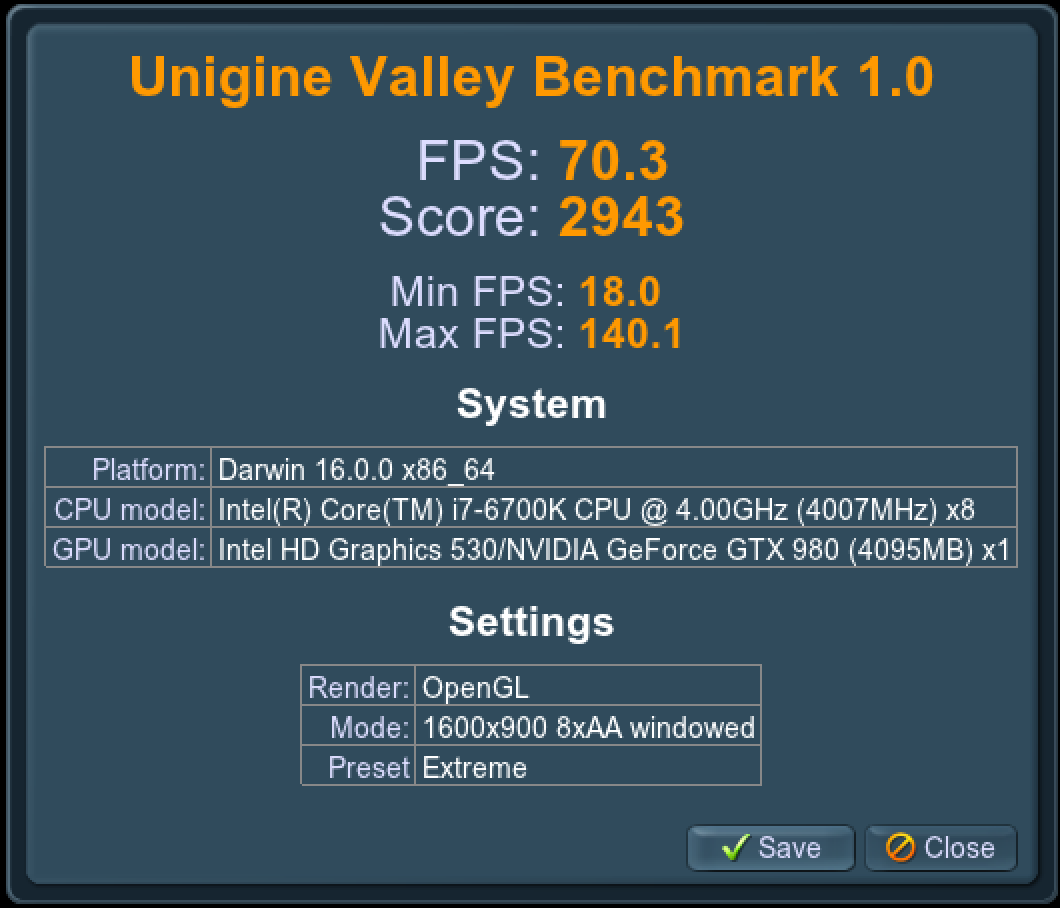

I get 70 FPS with a GTX 980 using a 4 core i7 hackintosh:
High end video cards will be CPU bound by the old Mac Pros in gaming.

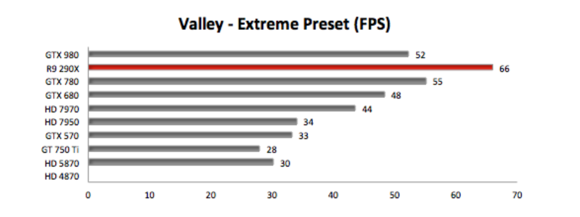

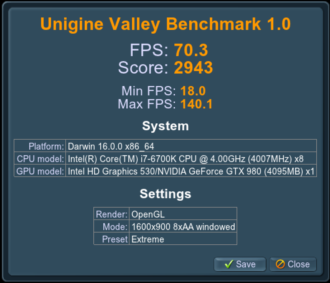

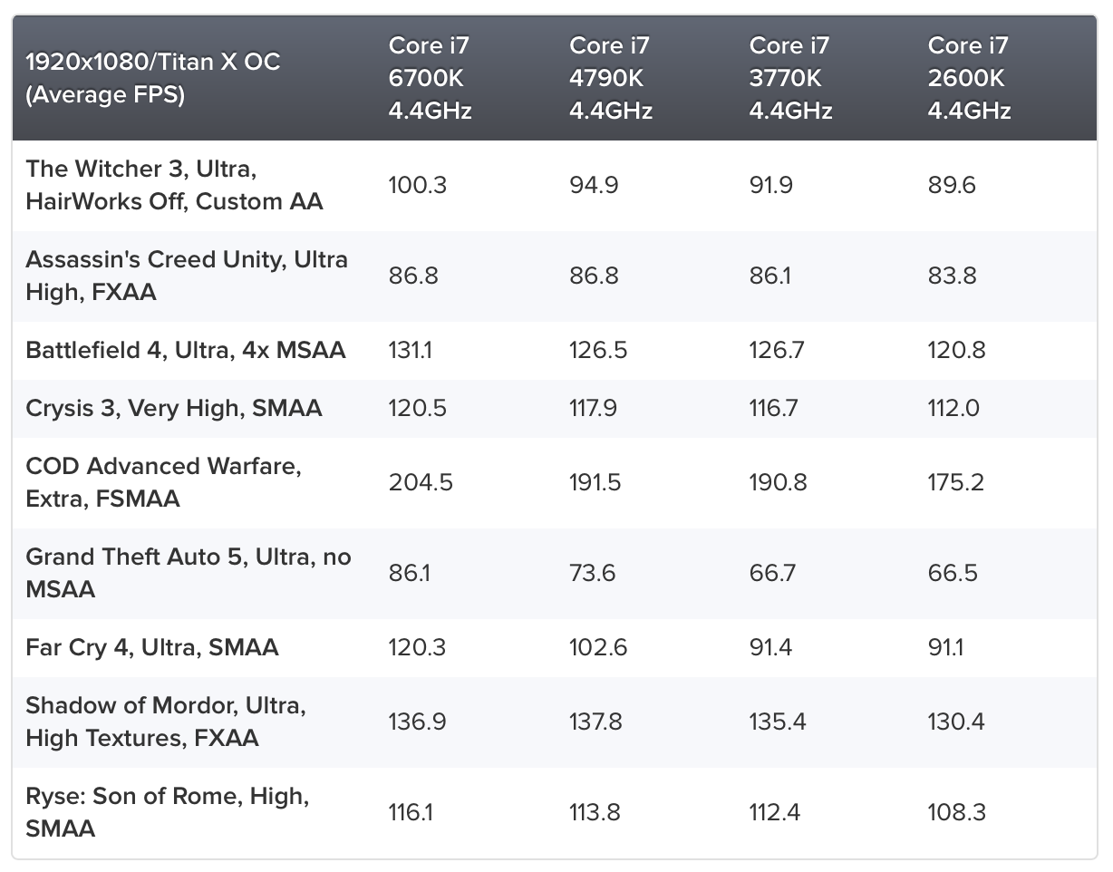

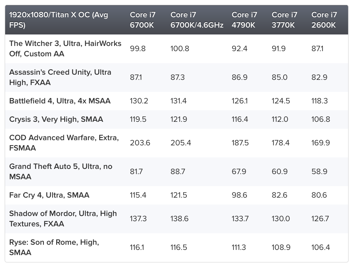

Here is a video comparing different CPUs for gaming. The oldest CPU used in the test is an i7 2600K which was released in 2011 (same year the X5690 was released). Also, keep in mind that X5690s run at 3.46GHz and there's no overclocking ability on Mac Pros. The OP is running W3530 at 2.8GHz.
Intel Skylake Core i7 6700K vs 4790K/3770K/2600K Stock Gaming Benchmarks - YouTube
