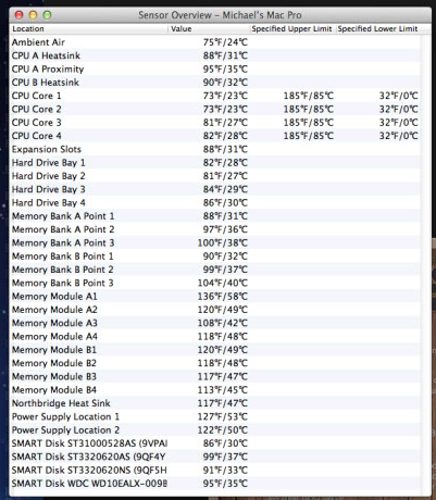

It's an interesting statistic that shows the vast majority of HDD's die at 26˚ and under though. I want to speculate that this is because (I think it's true) that most drives die shortly after being turned on one day. Rrrrrreeeee....POP! But I have little evidence to support this. Mine look like this:

Thank you Tessalator. I knew you'd have some advices.
My drives hover between 36 and 39 most of the time. I will likely pull the Maxtor since it's so old and I don't really need it.

I use smcFanControl and have all fans set at 1026RPM (or as close as I could) and this it what my temps are.
Two 320G drives in Raid0 (bay 1 and 2) and two 1TB drives in Raid1 (bay 3 and 4).
