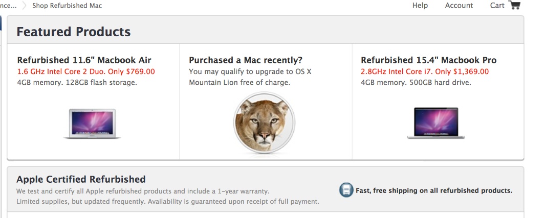

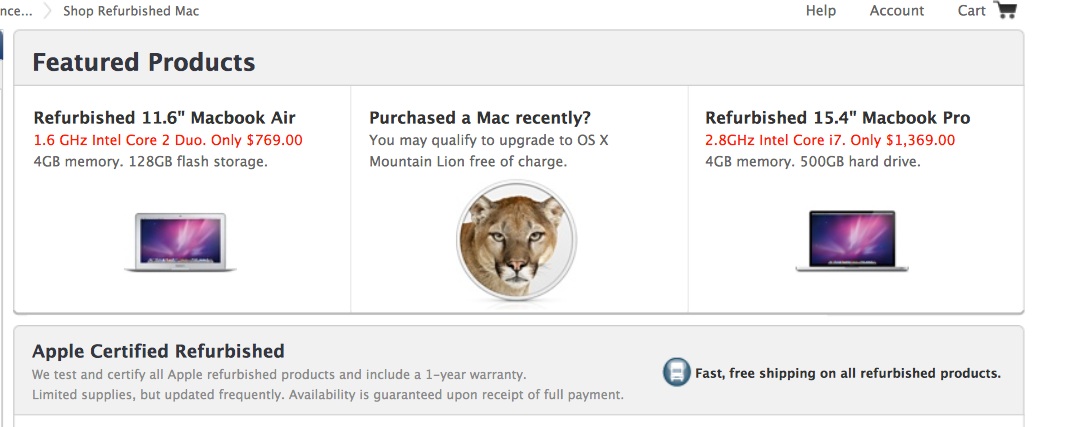

I agree with the other post - if you got you MP from Apple this past November you ARE COVERED under warranty (assuming you have not hacked your machine)
Quit mucking around here and take it into Apple under warranty.
I think refurbs only get a 90 day factory warranty.
No, same warranty, and same eligibility for AppleCare. Think about it for a minute: Apple does want to sell these systems otherwise the time spent in the refurbishment process is just lost. Sometimes the 'deals' aren;t exactly that great to get something with essentially no warranty. I've never had a problem with AppleCare or the warranty on any of the refurb Apple systems I've had.
