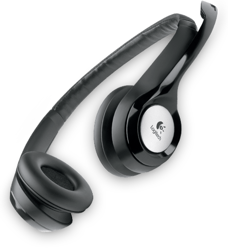

I am using a USB Logitech headset with Microphone
http://www.logitech.com/en-us/product/stereo-headset-h390?crid=36
Works fine on the classic Mac Pro. No unwanted background noise and plug and Play in OSX Mountain Lion or Snow Leopard. My only complain is the headset foam, it corrodes after a year of usage. Headset worked fine in Skype or Google chat hangout.
