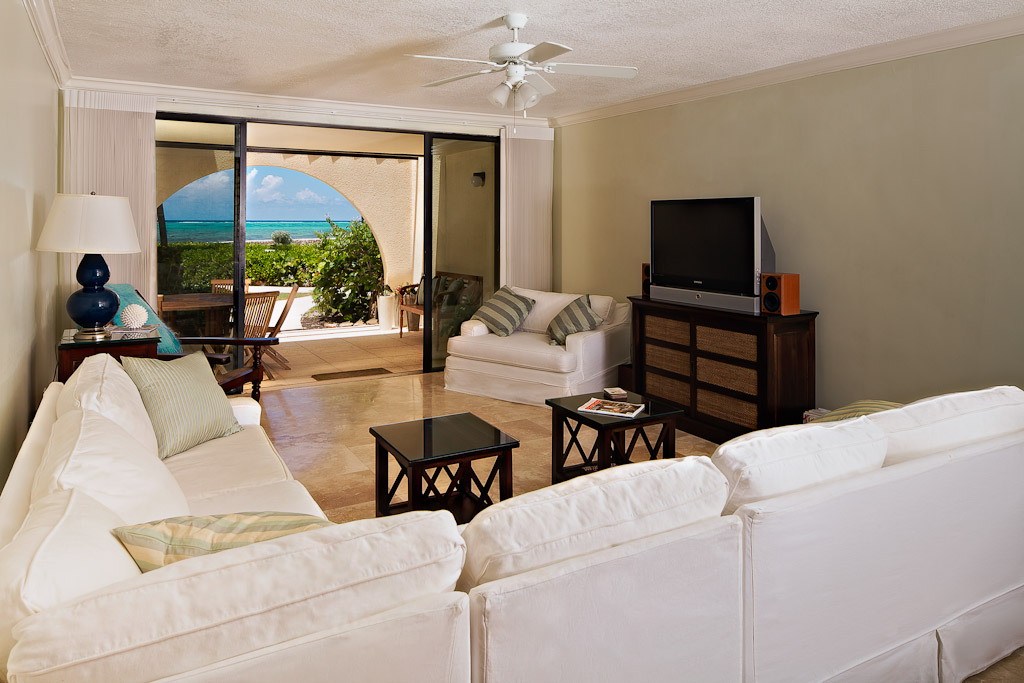

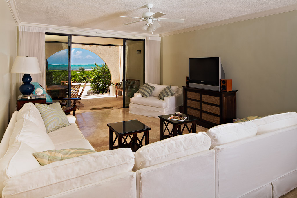

I've been playing around with Plex 9. Nice program that I had not seen before! I am finding the lack of mouse control a little off putting though. I can understand why that might not matter for a proper home theater...but still seemed hard to control things....
My current setup...is just a LED Cinema 27" on a Coffee Table that I use for TV via iTunes and Movies largely via downloads. Almost everything here is region blocked and it's only because I have a US credit card and iTunes goes based on that.....that I am able to get US TV shows.
I'm a little space constrained...but hey I live 100 feet from the Caribbean sea 🙂. That TV never gets turned on as the local cable is crap and so is the set!
Just need to redo this photo with my new Mac Pro in it!

Reminds me of when I used to live in Cancun, gorgeous.
