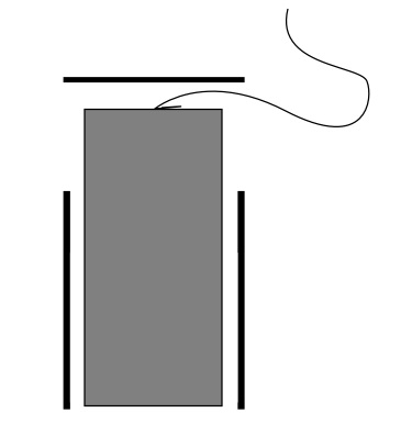

I have my Mac Pro installed in my desk, but it looks like this from the "top":
As you can see, there's airflow through the back of the area so that the warm exhaust can be cleared out. My temperatures are stable and well within the expected range.
