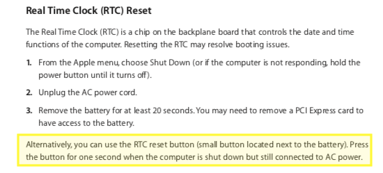

I've managed to install Windows 10 onto it via DVD. However, if I switch it off, it will not restart. I've found that if I press the small button on the motherboard (near the CMOS battery) it will then start - it's as if it's not saving the settings - what can I do to remedy this ? If I select 'restart' in Windows, it does so with no issues - it just doesn't seem to like a 'cold' start. I'm really pleased Windows has been able to load, because it establishes that the components are working.

first reflex is the clock battery. Even if replaced, check it. 3.0 Volts minimum when plugged in. Upside is plus, minus on chassis. There are real bad CR2032 cells on the market. Anyway, the correct type is BR2032 what can stand higher temperatures and have another discharging curve.

Thank you so much for such a helpful reply - I never realised that the correct battery is the BR2032 - that's certainly worth knowing and I'll order a couple.
Also to note: after changing the battery, a nvram and smc/rtc reset
