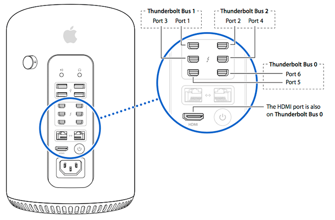

Lots of PCIe lanes is excellent, and Xeon multi-CPU for even more PCIe lanes. But it is lost on the Mac Pro 2013 with the proprietary 300 pin connectors and lost on the iMac Pro being a solution not made to be opened to upgrade manually. The throughput on the Thunderbolt ports is limited if using them as pass-thru for the display, whereas plugging the display directly into the GPU then those Thunderbolt ports would be available for other purposes (including as pass-thru for PCIe).
are you sure about that? In what way, by what amount, will the throughput be limited? This is new to me.
Can anyone else corroborate? If I connect three 4k displays to Thunderbolt 2, do I still have the full PCIe bandwidth available for use as pass-thru?
AFAIK there should be no bandwith limitation because of a display connected to the same Thunderbolt bus. what should be avoided is connecting two Thunderbolt devices to the same bus.
The Anandtech review should give you an idea of the bandwidth to all devices. There is a PLX PCIe Switch, which according to Anandtech, should give full bandwidth to any device connected, even when a 4K display is connected to each Thunderbolt bus.
https://www.anandtech.com/show/7603/mac-pro-review-late-2013/8
https://support.apple.com/en-us/HT202801

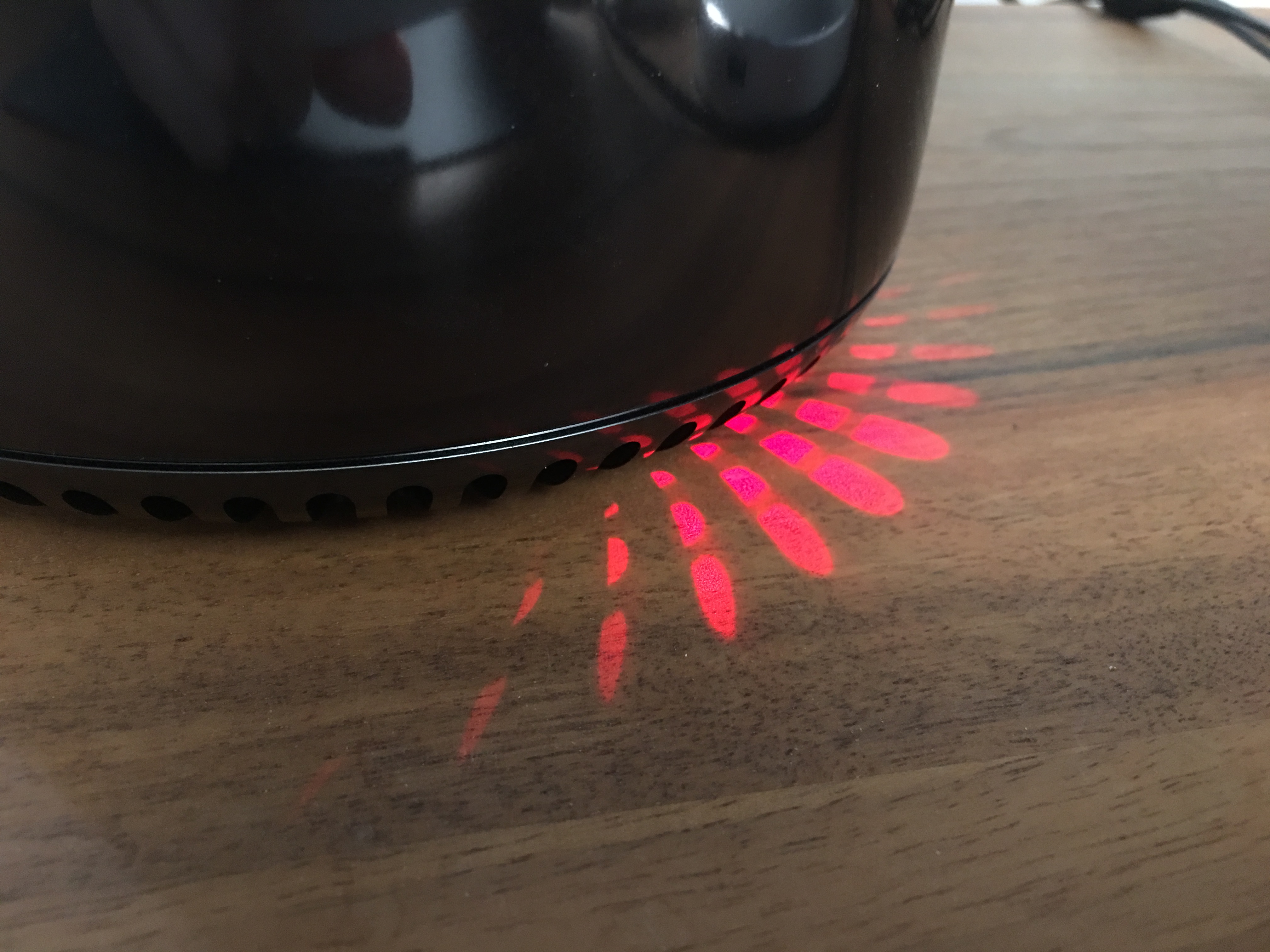

When the Mac Pro gets hot (sustained load for CPU and GPU, enclosure temperature above 36°C or so), a red light appears that is visible trough the bottom holes. Everything continued to work fine though. Once temperatures drop, the light vanishes.
The same light was (sometimes?) also visible after waking from sleep under macOS before I installed the third SSD. The manual doesn't say anything about that, so I'm not sure what it means. 🙂
@Kris Kelvin I forgot to mention the lights! It's alive! On first power on, it will show blue, red, and green lights if I remember correctly. Glad you got Windows installed and working. I always just used it in a VM for my needs.
