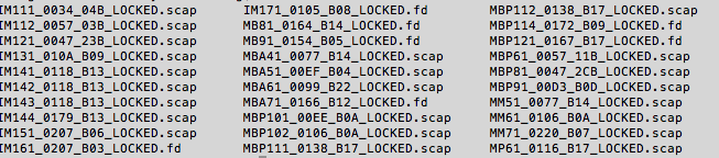

[doublepost=1470330504][/doublepost]The 10.11.6 combo has an EFI files directory containing these files:
Mac Pro identifier is bottom right.
