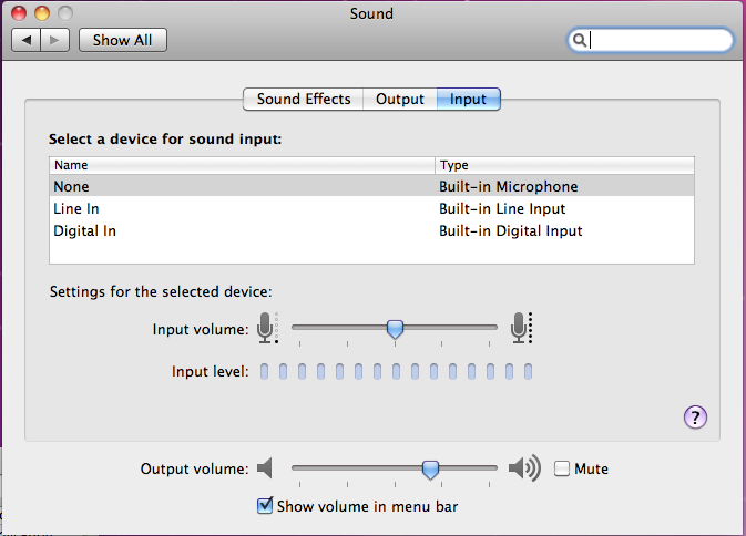

What is even more interesting is that I went to the Apple store yesterday and look at a 2009 Mac Pro. I went to System Preferences --> Sound --> Input and actually saw an entry for "Built In Mic". Can anyone with a 2009 Mac Pro confirm that? Does that mean the new Mac Pros have dual functionality in these ports (like a Mac Book)? Can anyone confirm this?

But can someone who has a 2009 Mac Pro verify this for me. Go into your System Preferences --> Sound --> Input and verify whether you see an item that says "Built in Mic". This would indicate there is a built in "mic in" in the new Mac Pros. Which would mean you could plug a microphone (1/8") into the Mac Pro now????
Could this have been a 24" display's built in mic?

lbodnar, you make an excellent point. I think the monitor was an Apple 30" (with a built in Isight?). It could be because of that?

Okay, so I went to the Apple store today and took some screen shots on the 2009 Mac Pros . It looks like it has a built in mic in (they were no help in explaining if this was the case compared to old Mac Pros).
