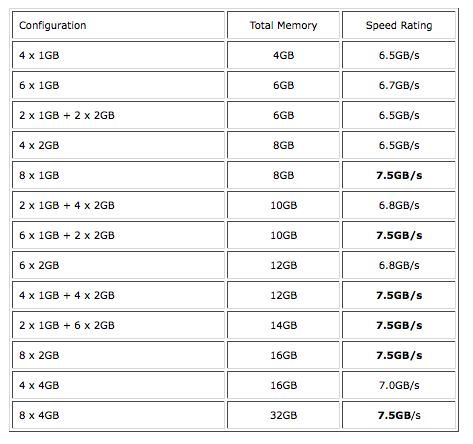

In the Table below (attached), Bare Feats and OWC have reported the following results for the Copy, Scale, Add, and Triad functions of STREAM to produce a single speed rating in gigabytes per second.
Are you seeing compatible results when running Geekbench?
I have 16GB installed on a 3.2GHz 8-core. 8 x 2GB using all 8 slots, but only seeing 3.5GB/s

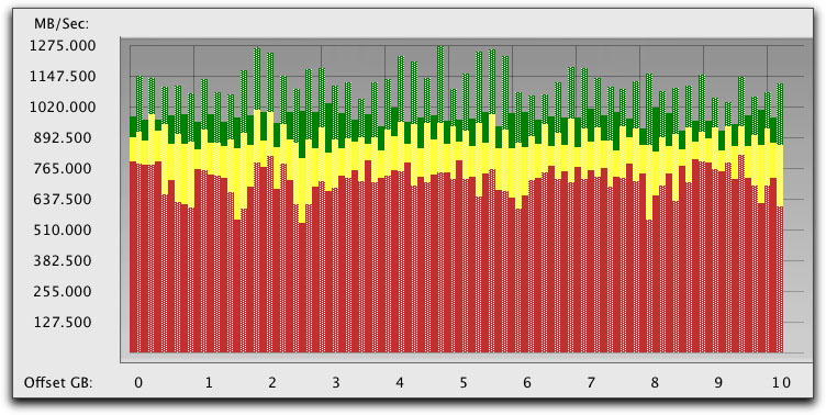

Yeah... the same benchmark performed from barefeats clearly states fill up all 8 slots and expect to see 7.5GB/s average speed and I'm not seeing it.
And... because I'm not seeing those results... I'm asking the community if they are seeing 7GB/s+++ or not. A VERY SIMPLE question.
it seems your issue may be with that specific ram, or it may not be installed properly...
- If the memory was not installed properly; then I wouldn't be able to see 16GB from system profiler.
- System diag. & profiler clearly reports all 8 RAM's are detected and okay running at 800MHz.
recheck and then complain to OWC if you have an issue...
Yeah. That's what I'm trying to do, but I need additional facts.
As clearly stated on my post... when looking at other results from Geekbench from those who have a compatible machine MP 3.2GHz with 16GB; their results are in line with mine. Memory stream test hitting the wall at 3.5GB/s not 7GB/s+++
Maybe... Geekbench is simply reporting the wrong data. Who knows, but that's why I'm asking others in the forum.
We have worked very hard over the past 20+ years to create a name that's synonymous with trust in the Mac community.
The test used was a terminal-based, 64-bit, parallel multi-threaded test that was provided to us from Rob-ART at BareFeats who obtained the same results that we did.
http://www.barefeats.com/harper3.html
Basically the test is not bound by the 3.5GB allocation restrictions of a 32-bit OS like 10.5 - This is why your results using a 32 bit version of Geekbench would vary.
Other World Computing has never and will never intentionally mislead our customers or post incorrect information to dupe anyone into making an uninformed purchase from us.
OWC's web site does not have any reference to the test being performed at 64-bit nor using a custom test app. It would be very nice for consumer to be able to run the same test.
Also, when providing a link to the "STREAM benchmark reference information" or the test tool that may have been used is from the mid/late 90's it doesn't look too promising.
As clearly stated on the original post; I ran both 32bit and 64bit version of GeekBench. Yes, 64bit reported a higher BW on the Stream test, but it was a mere 10% increase over the 32bit. Based on my test, the system was unable to go over the 4GB/s when tested with GeekBench 64bit.
Very good. Can you now please update your web site? Would love to see an actual instruction for customers to reproduce the performance test or have results from GeekBench or other standardized testing tool.

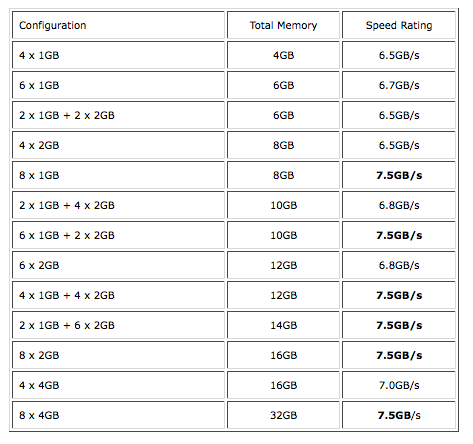

As stated in the third paragraph of the original article, we at Bare Feats Lab were testing with a "special 64-bit parallel multi-threaded version of STREAM." Geekbench does not a use a multi-threaded version of STREAM. Our custom STREAM was created for us by the author of Geekbench to squeeze out the maximum throughput of the memory bus.
Here's the link to the original article:
http://barefeats.com/harper3.html
Yes... Your report/summary does clearly state such information, but not on the OWC's site!
Fair enough. Despite having links to the test for more information on the test itself, we have added the same wording to our test site to help eliminate any possibility of misunderstanding.
