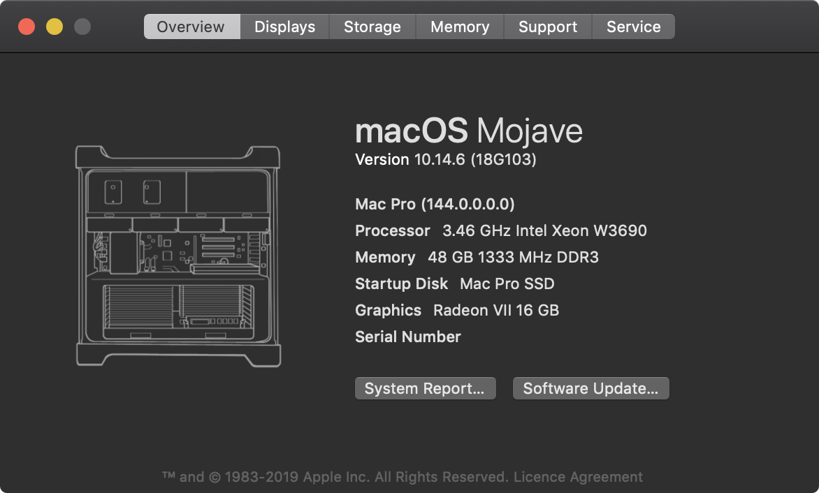

It’s a well known fact that those W3xxx CPU can run 3x16+8 = 56GB RAM on the cMP.
Same as my W3520 and W3690, Intel said 24GB max, but I can run 4x8GB, 3x16GB, and 3x16+8GB without any issue.
OP's issue isn't really the CPU spec related. You may call that config is not supported, but definitely can work on cMP.

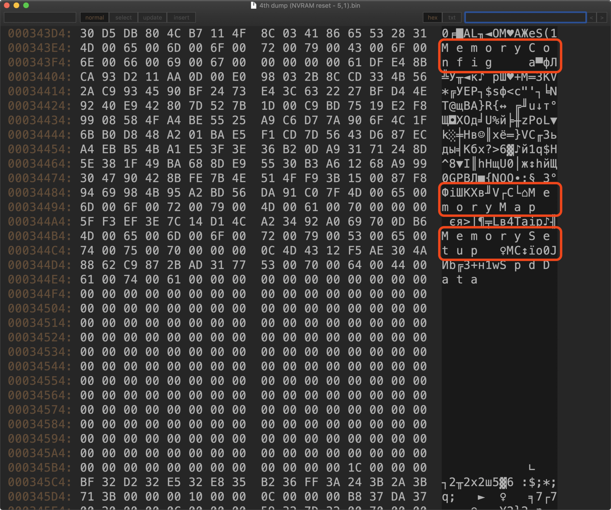

Also, for your info, memory config is stored in the NVRAM private stream. Even that can't be cleared by NVRAM reset. However, NVRAM reset may force the cMP to re-detect the memory config. This may be the reason why NVRAM reset can fix the very popular "wrong memory clock speed" issue (after memory upgrade from 1066MHz to 1333MHz)

Possible, but very rare. As I said, the memory config is stored in the firmware. Therefore, memory issue can be firmware related.
