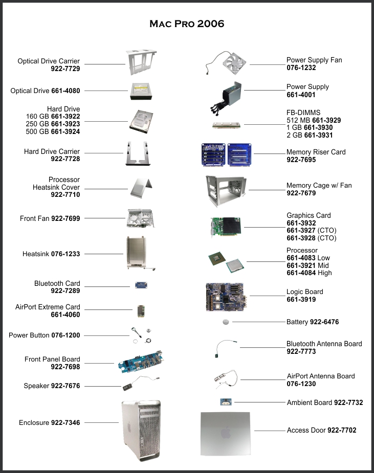

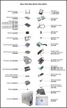

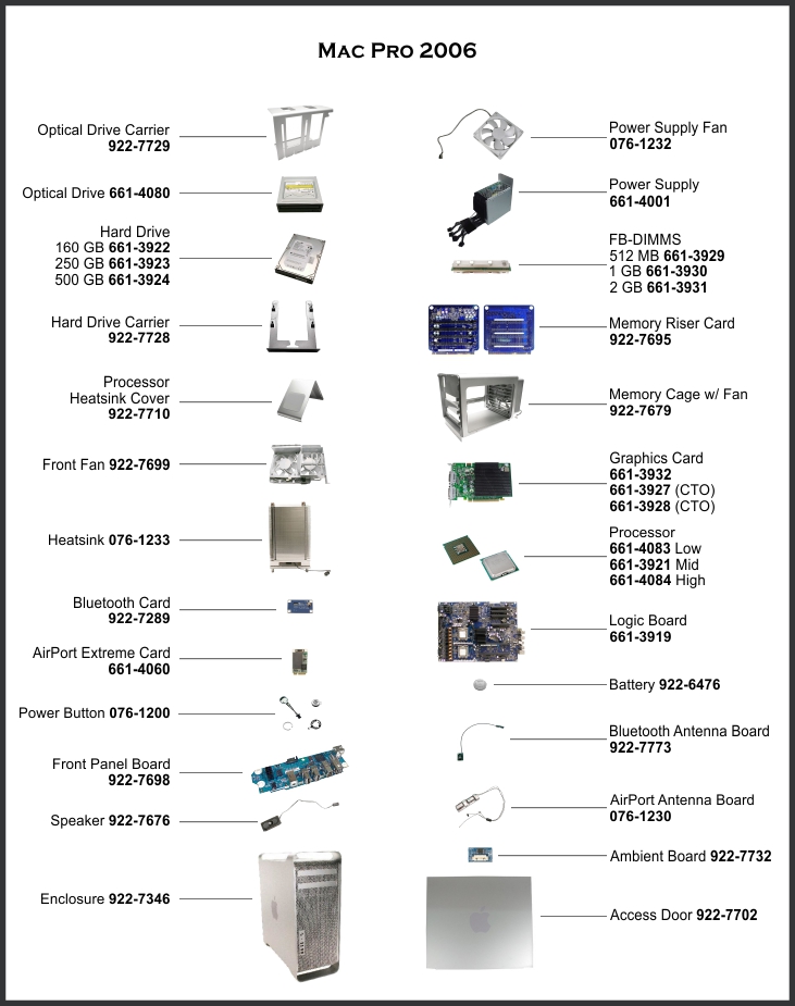

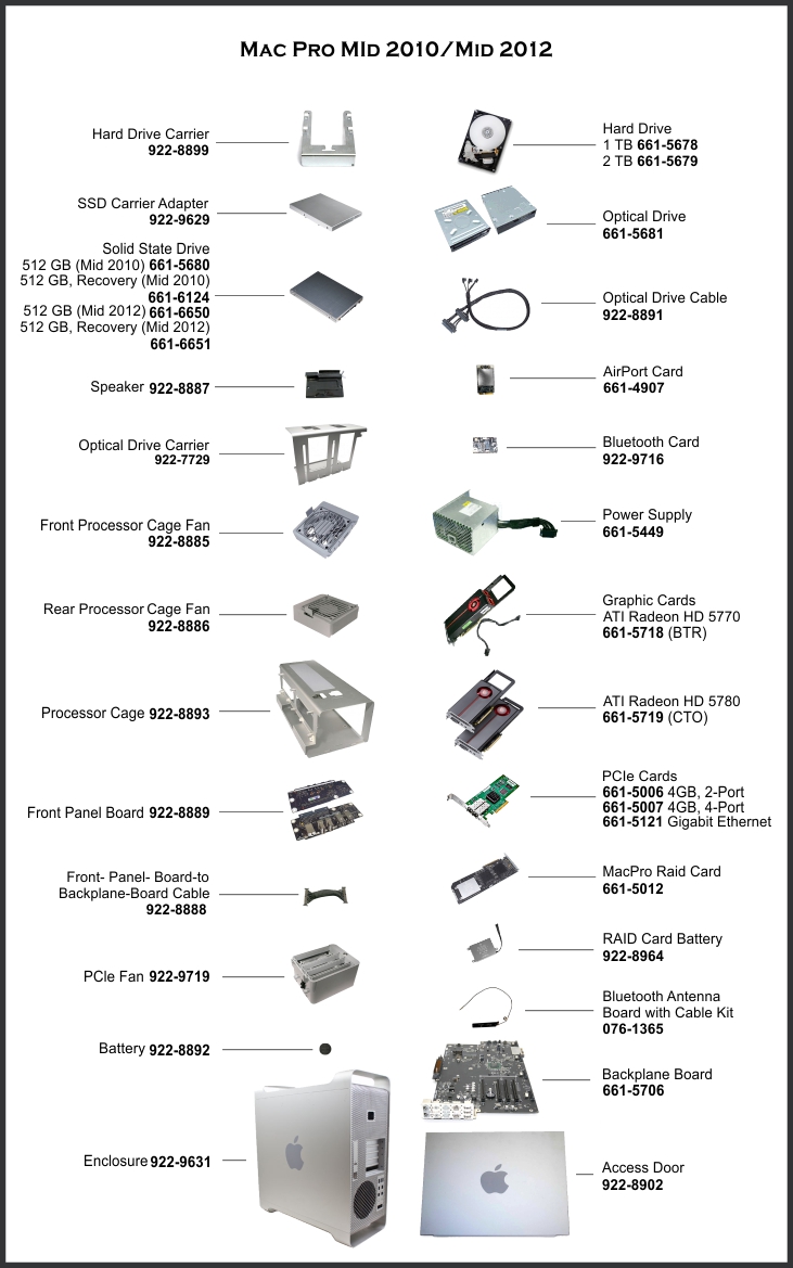

I doubt if that's out of stock or never exist, the 4,1 / 5,1 PSU fan part number not even exist in the technician guide.
You seem to be right. It is just gone from the parts list compared to earlier macs, never noticed that 'till now
P.S. my cMP1,1 is on the loan to a friend right now, but as soon as i get it back ill open them up and compare fans, just for the sake of it.
