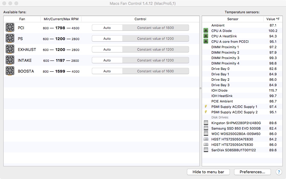

I am running a fan-control utility and all the temps are normal or below, nothing over 114°F . I have checked the heatsink without removing it and it seems to be solid and doing it's job as is the Northbridge.

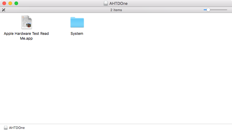

The link to AHT for my Mac didn't work—disk image corrupt. I'll look for ASD. I really appreciate your help.
Well, my very first thought was the PSU, but since it starts and runs in safe mode I was hoping that wasn't the case. I should probably buy a PSU for future repair anyhow as I have two nearly identical Mac Pros.
You probably did something wrong, follow the instructions to the letter.
If you have two Mac Pros, use the good one to reinstall macOS on a empty disk then install it in the problematic Mac Pro. Start exchanging parts to test, first move the GPU and then the PSU.
[doublepost=1563717226][/doublepost]I just checked AHT links and it's working.

I figured it out and am now testing. The short test found no issues, so I am running the extended test but it seems to be hung up after 1 min 55 secs. It's been 10 mins, but I'll leave it and see if it ever moves.
