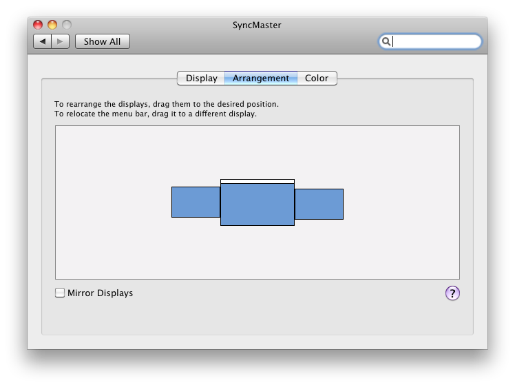

How does desktop mirroring work? Is it as simple as selecting "desktop mirroring" somehow in the system preferences in the OS? Then everything is mirrored? That seems like a great solution. Thanks!
In system preferences choose "Displays" then the "Arrangement" tab. There is a checkbox for mirroring down there.
Great! I think that is the solution. The only question is if the mouse/keyboard will really work running through the USB input on the second monitor, out the DVI, through this converter device, over the cat5, back through another converter, and back in to the Mac Pro tower. Only one way to find out!
