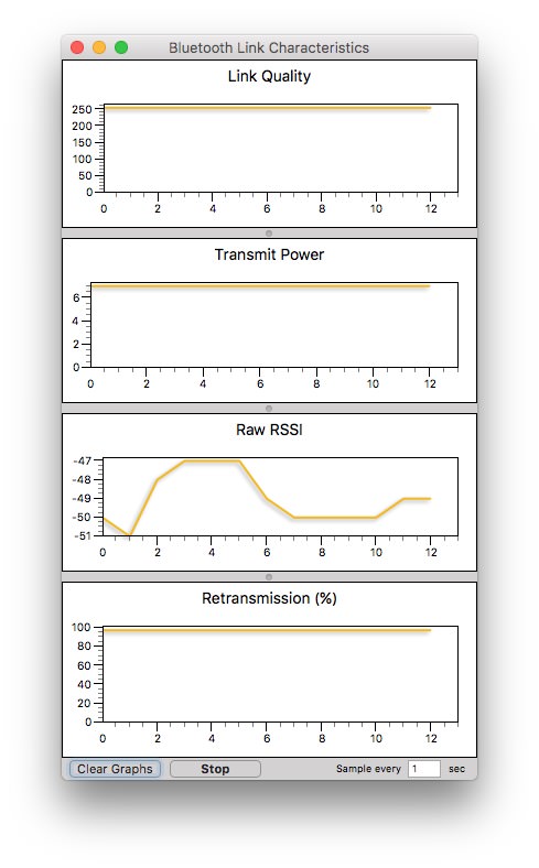

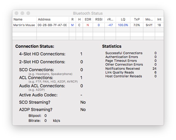

Also, you may go to Apple developer page, and download BT explorer. Which will allow you to monitor the Link Quality, Raw RSSI , etc. This can help to diagnosis if the unstable connection is due to antenna signal too weak.
P.S. Anyone know what retransmission is? With the Broadcom card, it always start from zero, then slowly increase to 100% and stays there (until next restart / reset). However, if I use a cheap 3rd party USB 4.0 dongle, it will stay at 0%.

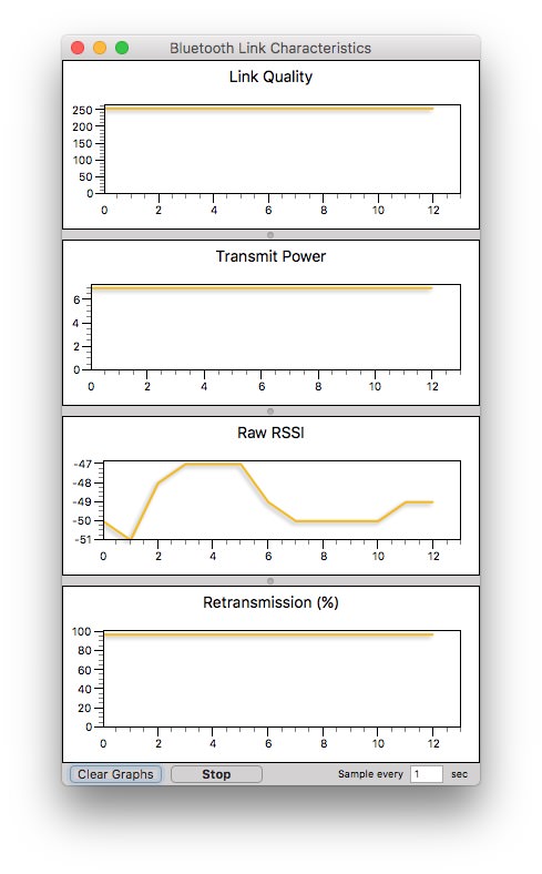

View attachment 697778 View attachment 697779
