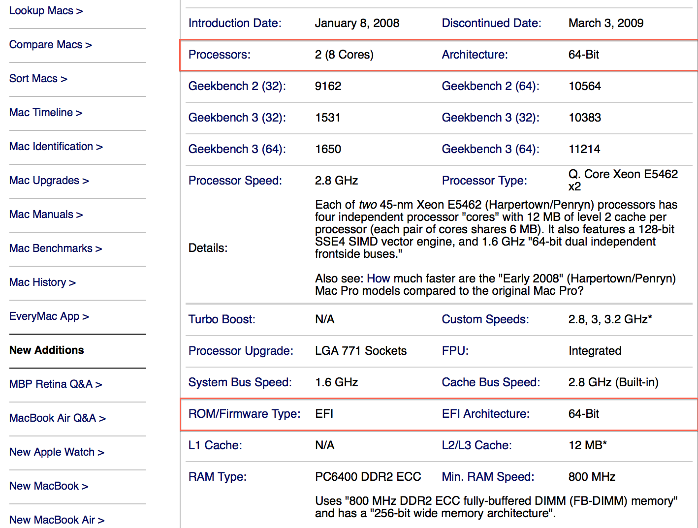

The probable reason your 680 mac edition has no boot screen is because it uses a 64bit efi, and your mac is 32bit. The 680 mac edition was made for the 64bit efi macs only.

If he has the 2008 cMP.

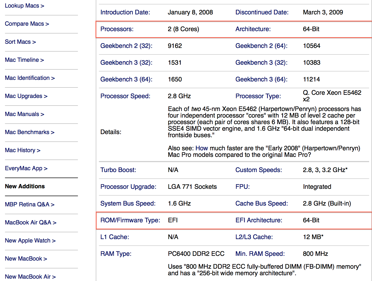

I was under the impression that my 2008 or 3.1 Mac Pro was the first 64bit. But even if it is or is not, the things you have said seem to make sense. I tried what you said and I'm no better off. It still appears that the Mac Pro has stopped responding to all keyboard input. The original keyboard that came with the MP was one of Apple's unreliable blue tooth ones that do not work until you boot up anyhow. Just to be sure it was not the razer at fault, I hooked up another USB key board and got the same result... nothing. In the original post I mentioned that at first I had the Mac Pro in target disc mode, this was done with the razer. I have no idea why the Mac Pro started to ignore all keyboard inputs, because if I could get it again into target mode, I would try to install onto a fresh hard drive, as my cloned back up would also contain those windows instructions you mentioned. My only concern is that my snow leopard disc does not contain the drivers for the GTX680. I wish Apple would sell DVD or USB operating systems!!!

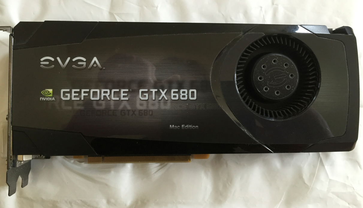

Be aware that today most 680s sold as "Mac Edition" are flashed PC cards (even unflashed sometimes, it's just the magic word that helps selling it twice the price). The real 680 Mac Edition has a metal bracket that extends from the backplate and looks like a big black handle that fits into a slot close to the mac's PCI fan.
If your card is indeed a PC card you might want to flash it yourself properly to get the boot screen.
The boot screen might not show on all ports, it did show on the DVI port but didn't on the HDMI and DisplayPort on my flashed 680. I don't know how this works on a real Mac Edition.

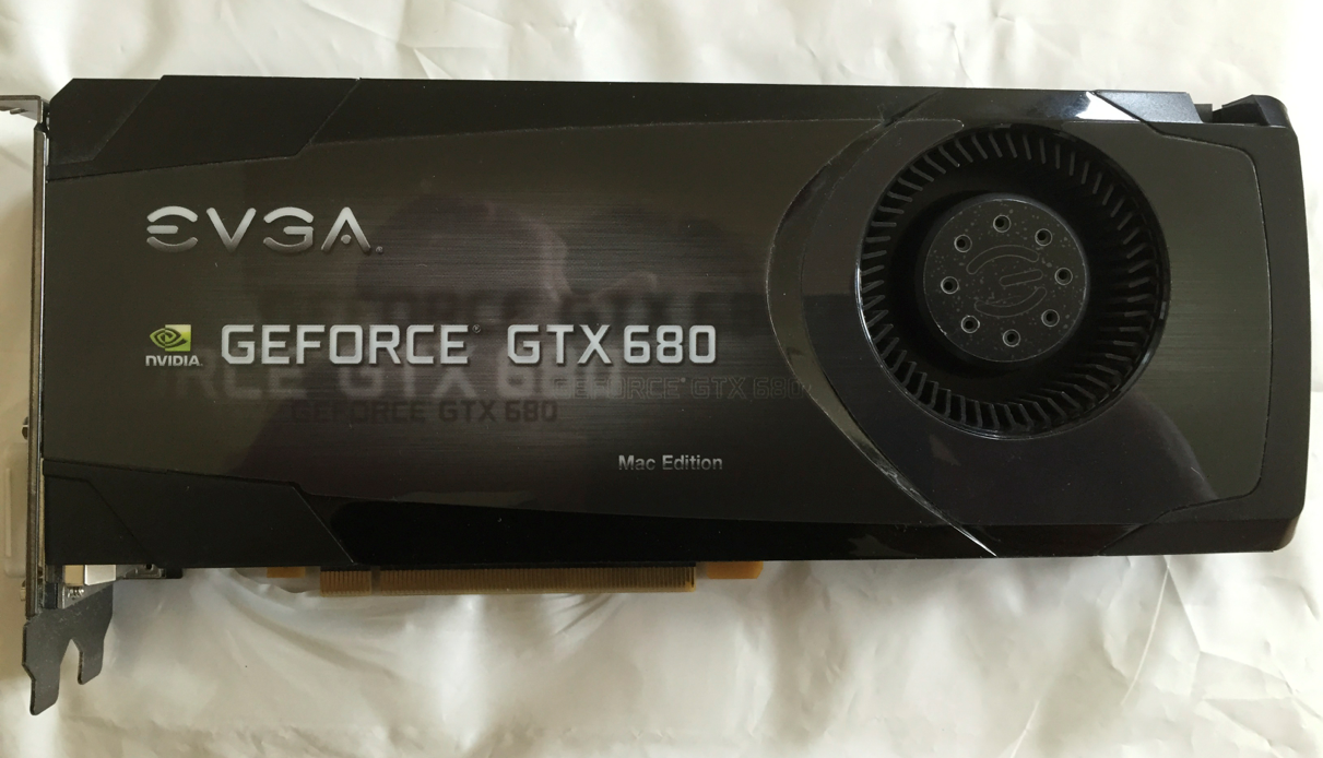

Be aware that today most 680s sold as "Mac Edition" are flashed PC cards (even unflashed sometimes). The real 680 Mac Edition has a metal bracket that extends from the backplate and looks like a big black handle that fits into a slot close to the mac's PCI fan.
No, the original GTX 680 Mac Edition has no metal bracket that extends to the PCI fan. I have an original Mac Edition, and it doesn't.
I think you mix up with the Apple ATI Radeon HD 5870: https://www.macrumors.com/2010/08/09/apple-to-offer-ati-radeon-hd-5870-card-for-2009-mac-pro/
Oh yes sorry I mixed up with ATIs, 4870 had the bracket too. Is there anything that helps recognize a genuine Mac Edition ? Pictures from EVGA seem to show "Mac Edition" written on the top sticker.
Yes, it's written. Attached a pic from my GTX 680 Mac Edition:
