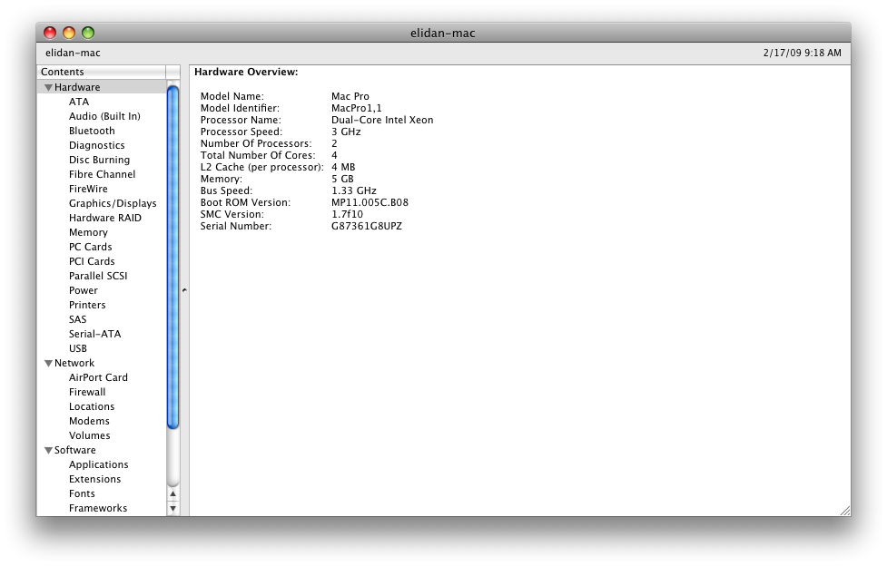

Configuration:
Please see attachment for System Profile information. The
machine has two internal drives; the original Apple included
250 GB ST3250820AS P and a 500 GB Seagate ST3500320AS
which I added. The 250 GB boots Tiger which had not been
used regularly for a while and was patched last Friday to
10.4.11. It seems like the symptom became worse after the
patching on the Tiger drive. The 500 GB drive runs Leopard
which is patched regularly and currently is at 10.5.6.
