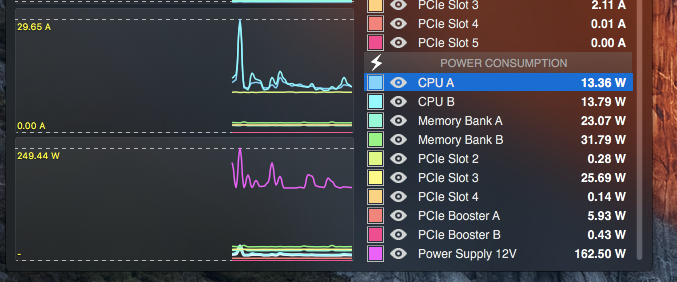

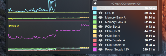

here is my 3.1 at idle and under load, about the same
Screen Shot 2017-11-17 at 12.33.44.png Screen Shot 2017-11-17 at 12.36.12.png
Thank you, mate! 320W, dunno why people say thats much. Thinking of it, isn't that 4 casual 1990's light bulbs consumption? ;-)
well it's a lot compared to any modern system, my 5.1 only used 20w under load for ram while the 3.1 uses 90w for ram 😱 the age is showing.
my 5.1 uses 330w max on the same test but it's got a GTX770+usb3card+ 6 drives and more ram, the 3.1 only has a gtx660 and 2 HD's so thats not bad but modern cpu/systems at idle use way less power.
my sisters macbook pro is faster than my 5.1 😱 and id gess it's using under 100w
