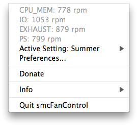

Don't forget Apple has changed the position of the Top Memorycard Riser too, they've flipped it 180° making room for the fairly fat chip prior to bolting on a huge heat-sink - so the upper memory banks actually hang down over the lower slot. Because of this I do wonder how would the extra heat affect the memory modules in the long run. Looking at my screen grab the temps seems to be in the forties, is that normal? - Oh, that's after i boosted the fans the CPU and Exhaust fans to just under 900rpm.
I've also boosted the IO fan so the HD's not heat up too much.
