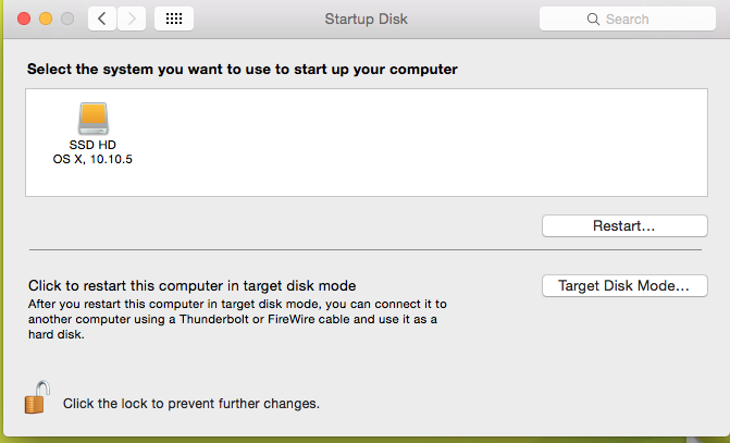

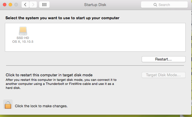

Try going to System Preferences/Startup Disk and making sure that your boot drive is highlighted.
its the only drive there, but the image is funny. It doesn't look like a standard hd icon. I'm going to do the procedure lucas laid out when I get home from work.

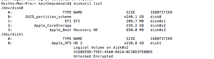

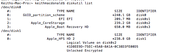

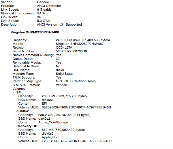

Anyways, I made the usb install for yosemite and tried to repartition the ssd to guid instead of a logical group. It wouldn't allow this so I followed some terminal commands, erased the physical volume group and voila, the ssd is guid, the partition logical. Should both be guid? I still can't get it to boot without a nvram reset. I think its the 7970? Im not only not getting the boot screen anymore, (did with 7970) before terminal, but It loads to the same screen with the circle and no go cross. Thats if I get it to boot. Do you think the power draw is too great?
I was told to install the windows support drivers from bootcamp to remedy this, or do you think its still the ssd? Terminal says its a guid partition, but disk utility states they are both still logical

sorry for the multiple picture uploads, Everything worked flawlessly before I turned on apple native trim via terminal
