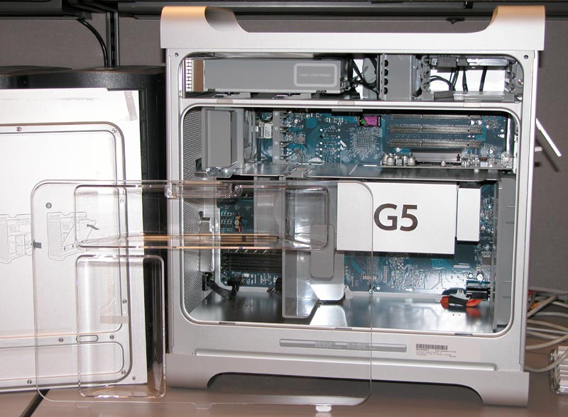

Is it possible to get a perspex door for a Mac Pro? One similar to the G5; this is because i would like to run some tests on airflow and i will be purchasing a GTX770 or 780 (i want to see the glowing logo 😛), would it be a DIY job or is there a place i can buy one?

I think you mean a G4...the G5 was an aluminum case just like the Mac Pro. At least mine was....
...and it had a perspex door inside, just beneath the aluminum side door. At least my G5's have.
I could "test" one when I get home. You'd need one from a quad core model since that one is flat and doesn't have the bump into seal the front fan better.
I had forgotten about that. I thought you meant the semi-transparent plastic case from the G4.
Looking at how the perspex door is formed, it would not work on my 3.1 machine as the have moved things around.
Yes, i have a DP PowerMac G5 door, ild like one that could fit my Mac Pro 🙂 Would it be hard to make?
Just get some perspex in the right size? It's fairly cheap to buy and there's bound to be a web-site you could order it from pre-cut to your required size.
After that it's an issue of what exactly you need, and how handy you are; for example you could do a full replacement for the metal side panel, but you'd probably need to cut out some tabs so it sits properly in place and either use a rubber strip for a friction fit, or try to make something compatible with the Mac Pro's built in latching mechanism (it's not a hard job, just very fiddly if you've never done anything like it before).
If you're happy only covering part of the machine like the G5 shields did then you can easily go for a smaller piece and maybe use some kind of right angle brackets to hold it in place, or even add something that can slip just under the hard drive trays.
In all cases, rubber strips for noise cancelling are a good idea as it may be hard to get a perfect rattle-free fit with a DIY shield.
