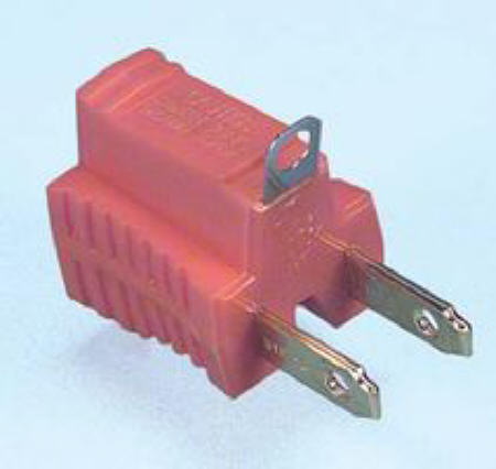

I was wondering what the best and safest way to convert the 3 prong mac pro adapter for a 2 prong outlet.
cut off the grounding prong or look around for one of these:
Are you sure the outlet is actually grounded?
Ground on such adapters is accessed via the screw that holds the cover to the receptacle, but it's not going to work if the box isn't grounded (i.e. bare copper wire attached to the metal box via a screw in older wiring).
My old apartment building (built in 1955) in LA was like that. I must have bought like 10 of those adapters for various electronic gear. But at least they're cheap (about $2 a piece).

The little adapters will work in that case, but the ground pin isn't actually functional.
Run a wire out your window connected to the ground pin, shove into dirt.
Problem solved! 😀
I've run GFCI's that way; drilled a hole, ran a 12AWG wire (20A circuit) outside to a ground rod (house was originally built in 1956). Works quite nicely, and not terribly expensive. 😀
It might not be possible though, if you don't own the dwelling, as you'd need permission of the landlord before doing something like that.
Get one of the adapters and then buy a power strip. While the outlet might not actually be grounded, you are still decently protected.
So plugging the MP into a surge protector that is plugged into a non-grounded 3-2 pin adapter is ok despite the fact that its not grounded? I don't understand how this will offer any benefit above plugging the MP directly into the adapter?

You REALLY want a ground when working with a computer, especially an expensive one.
Many 2 -> 3 prong adapters have this little metal tab on it. Wrap a wire around that and find a ground somewhere.

Theres no way I would run without a ground. Even using a power strip will offer little help. No ground then no place to dump that extra power. It only takes one surge or lighting strike on the system. If you can't get it out a window or other opening I would use a 14 to 12 Ga. solid wire along a baseboard and to the closest water pipe. They make clamps just for that. If you use an adaptor, I would make sure it has a real good connection and not just wrapped around an eyelet.
