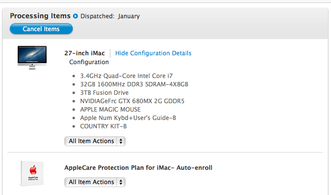

Buying a Pro at the moment is not something I'd really advise..I gave up on a true refresh and my upgrade is a maxed out iMac now. I guess if you are going lower end, you should be able to pick up a refurb at a good price from Apple, and they are fine...Fully warranted etc. so no worries there....I just think that the Pro ( even the top end ) is outdated now, and we don't even know if Apple will refresh it, or ( my guess) kill it off completely...I went with this:
