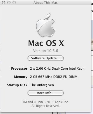

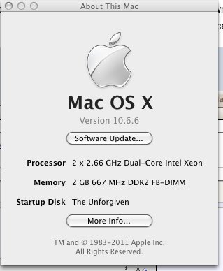

Alright it says DDR2 in the about this mac window, this is definitely the first Intel Xenon Mac Pro to be released. But I am still not sure if that means i can upgrade it to an 8-core, what do you guys think?.
It's not only possible, it's actually been done by other members. 🙂 Just make sure you get the correct processors and swap them out.
There's other threads on this here in MR, so do a search. You're after Clovertown based Xeons, which are the 53xx series.

The OP's machine is not a 2009, but either a 2006 or 2007 (both used the same board and memory; 2007 is when the first quad core CPU's became available to create the first Octad models).

Yes, you can create an Octad out of your existing system with the right processors. 🙂
As per memory, it' can only use 667MHz Fully Buffered DDR2 (DDR3 won't work in your machine; only 2009 and newer).
