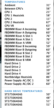

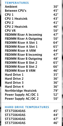

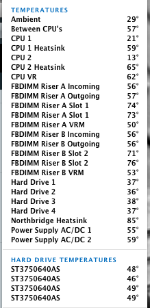

TEMPERATURES: I used iStat Menus to monitor the system yesterday. I focused on the temperatures. I was able to run my system for a good hour and a half before it crashed. The temperature climbed to 50+ degrees (see attached files). The first file shows the first 30 minutes, with no real programs running. The second and third attachment show 15 minutes and 30 minutes of running my digital audio workstation.

- The temperatures are high. But not that high? (Take a look.) The last two images show basically the same temperatures, and 20-25 minutes after the last image the system finally crashed.

Your memory and your northbridge look quite hot. For comparison I am doing a handbrake run right now (max loaded) and my FBDIMM Risers and VRM are in the 40's. My Northbridge is at 63. That is my ambient air at 24 and you are at 31 but still that is only 7deg difference.
Does your memory have the approved apple heatsinks?
Now I am on a Mac Pro 1,1 and you say yours is a 2007 or 2008 model? Can you verify the exact model?
