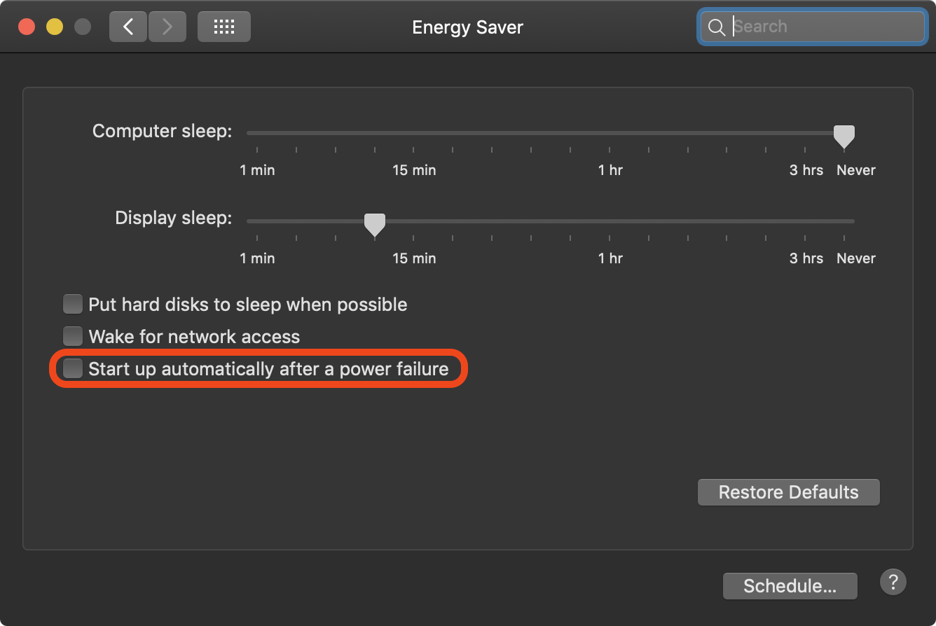

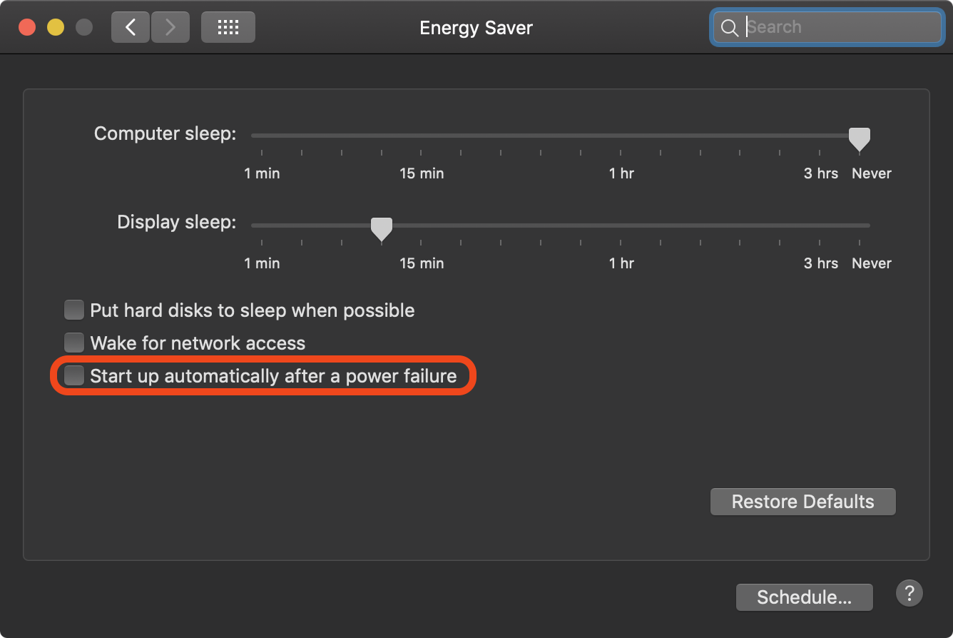

Few things you can try.
1) e.g. turn this off
2) SMC reset
3) NVRAM reset
4) change the logic board battery
5) try if a clean installed OS also do the same thing
You may also try if the following command can shutdown the cMP (without reboot)

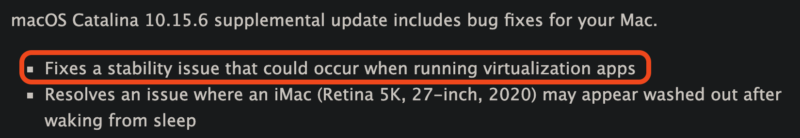

Thanks, was not able to do that huge test so far. But I have the feeling that it does not occur as long as I do not use my VirtualBox Ubuntu 20.04 Server VM that I sometimes use for compiling Linux binaries. However, I also can't reproduce by just starting the VM and working with it for a few minutes. Maybe this only occurs if the VM runs for some time?
10.15.6 has compatibility issue with VirtualBox. This is a known issue. And should be fixed by the supplemental update that just released.
