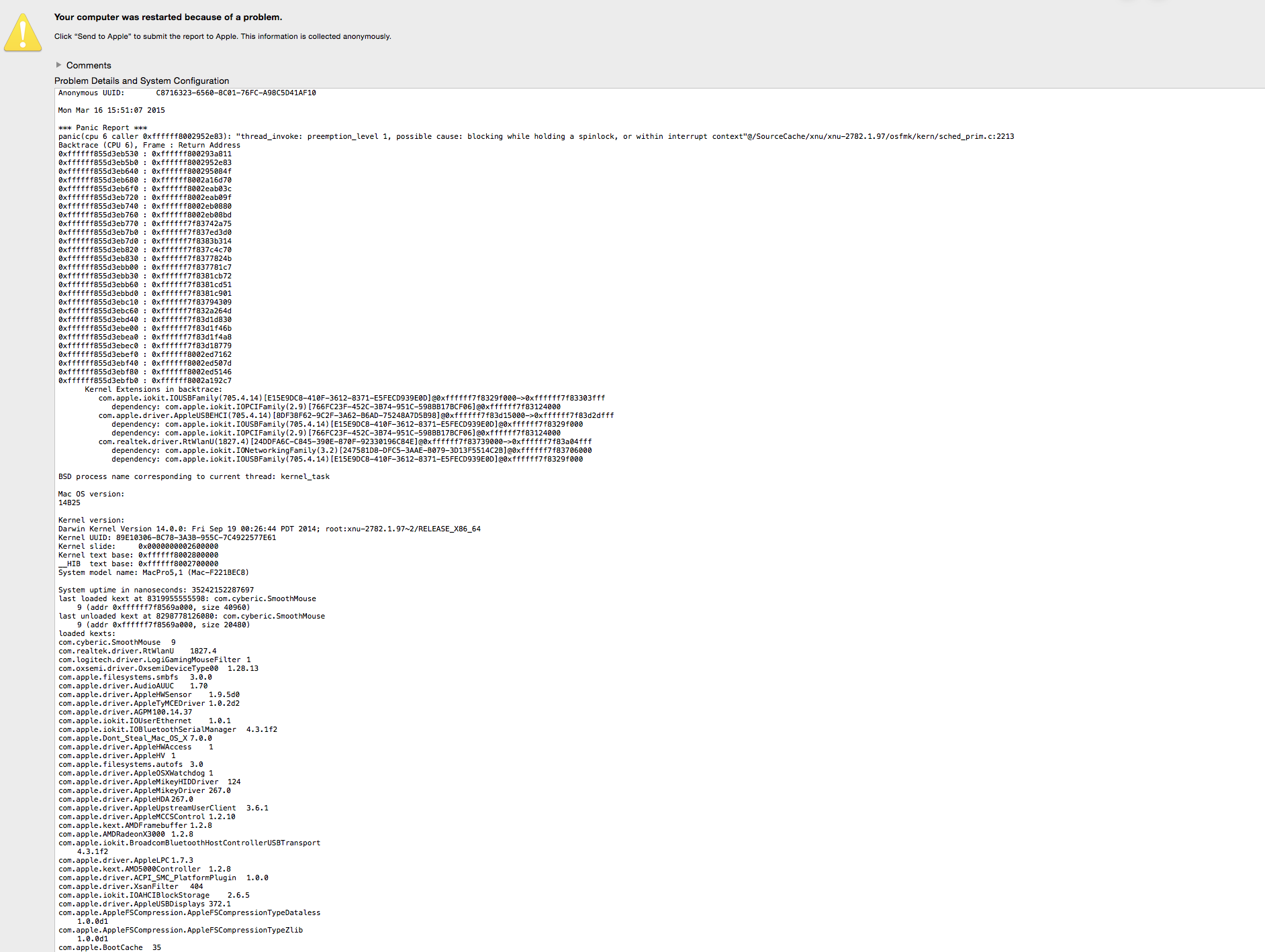

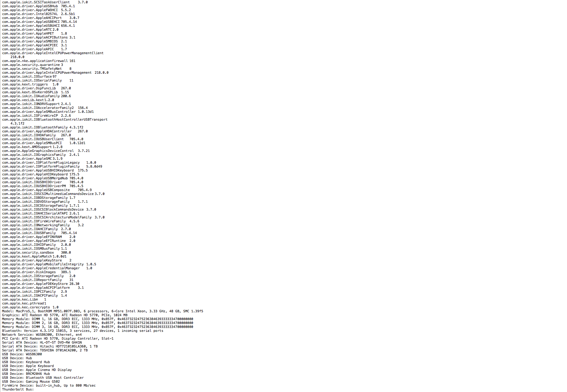

Here are some screenshots of the error message, maybe this will help you guys decipher what the problem is.
