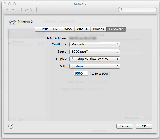

check the network settings/advanced/hardware and try to set them to 1000baseT and see if it changes...

Strange.
The card is capable of 1 gigabite so this is not hardware problem.
I had the same mac and it handles more than 100 mbps download.
In my case, I was limited by the router.
The cable seems to be horribly shielded on one pair, as you sync at GE and upload seems better.
The onboard adapters can use full Gbit fine, simultaneously, however a USB adapter will always be limited to ~450Mbit until 2013 with USB 3. FW ethernet cards seem to exist, but i doubt their use case over a USB 3 card and a good USB Gbit adapter which is cheaper and overall also more secure (as FW operates with DMA).
