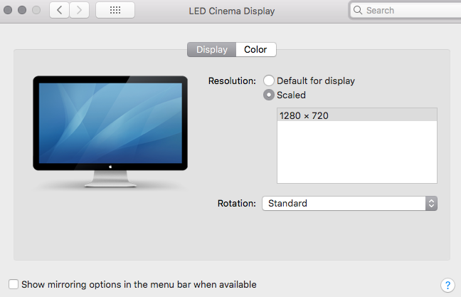

Today, I had to move my setup to another room in my house and upon setting things back up, only one display is being detected and even though it's detected, it is only displaying half the resolution (currently it's at 1280 x 720) and I am unable to change it to the displays regular resolution (see screenshot).

If everything was working, until you moved them. Then it's hardware issue, not driver issue.
Check all the cables, connectors, etc.
Also, you may try to reseat the graphic card.
Thanks, I've reseated the graphics card and it is in there firm and the issue still persists. I am now going to try replacing the adapter cables to see if there were any pins that had gone bad / were bent when unplugging them for the move. They won't come until tomorrow so I'll see what comes of that. For what it is worth, one monitor, as I mentioned, turns on, but with the half resolution, the other monitor, when plugged in to the graphics card display port, does not turn on at all when I try to test that out as a single monitor.
