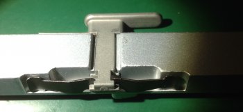

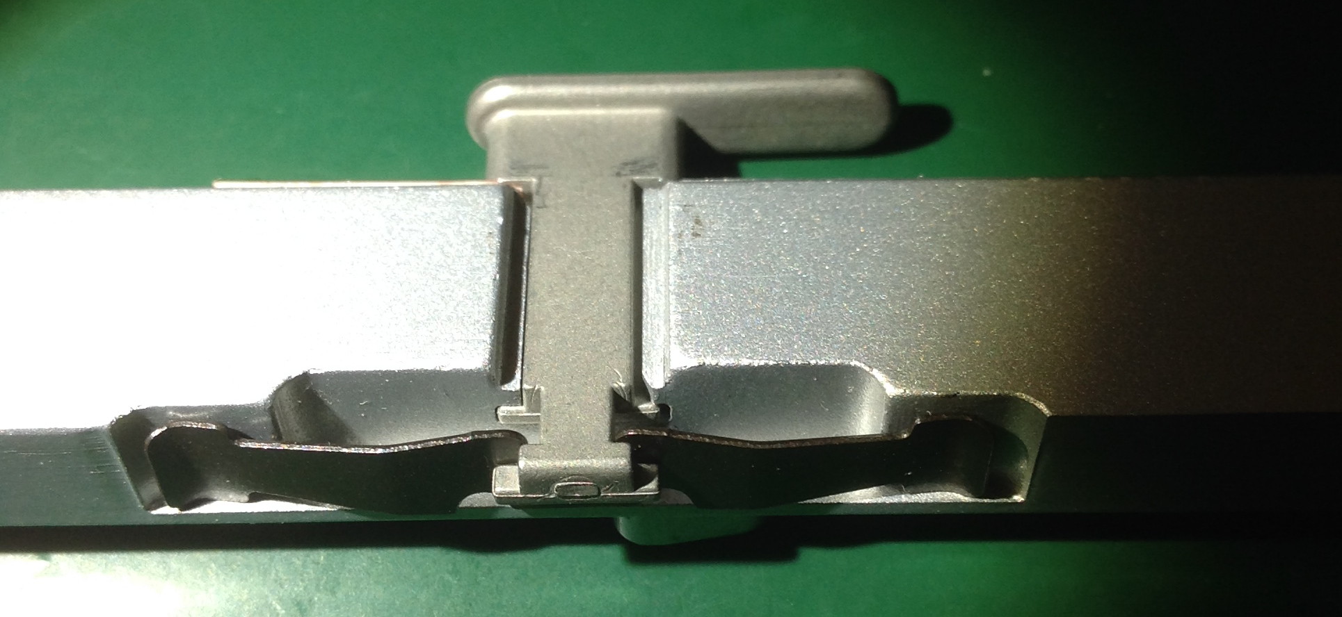

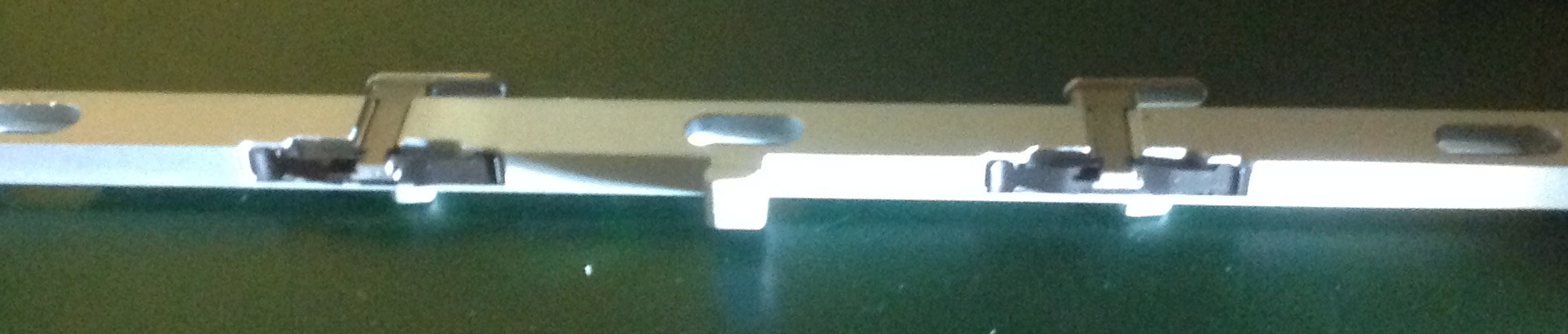

I know this is an ancient thread but it happened that I got a Mac Pro with a broken side panel lock mechanism.
Searched the web and the only thing I found was this thread.
Had a hard time taking it apart.
Hardest part was getting the tabs off to get the lever out of the case.
Its rather easy if one sees the mechanism behind those tabs and how to get off the springs, so here some pics for reference:
