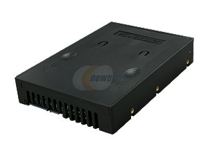

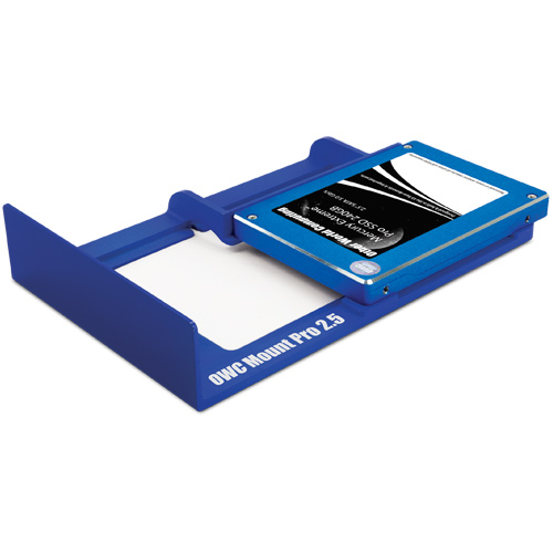

I had an Icy Dock 2.5" to 3.5" adaptor that was faulty and the drive simply didn't show up at all. I had to return it.
I now have an OWC bracket that allows the drive to connect directly to the Mac Pro's connector.

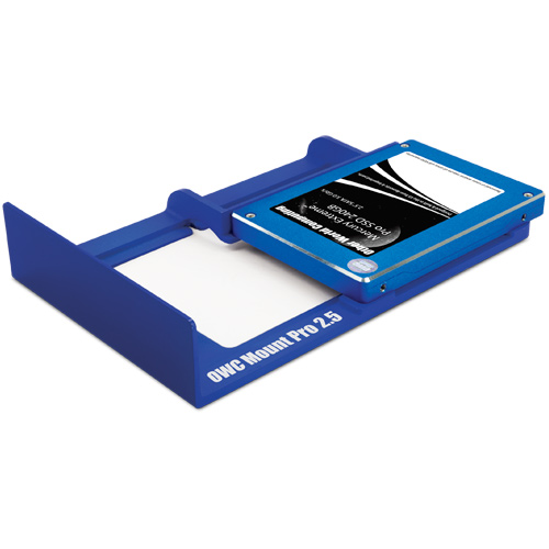

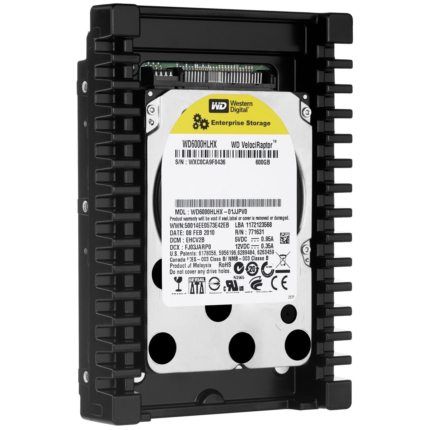

If you want something that looks cool and probably helps cool the SSD as well ...
I picked up some eBay new heatsink/mounts for "WD VelociRaptor" 10K hard drives (drive not included). These high speed drives are actually standard 2.5" SATA form-factor in a standard 3.5" SATA adapter with big heat sinks. They work great with SSDs mounted to the Mac Pro drive sleds and probably provide some heat dissipation as well. I think they were like $8 when I got mine, brand new (no disk drive included of course).
Here is what the original drives look like ... just mentally picture your SSD for the disk drive as shown:

I bought two icy docks for my 3,1 but construction of both were rubbish. I had to glue the grommets back in on one to get it working but it didn't fit exactly right and started to bend the SATA connector bracket backwards a bit. The other wouldn't work full stop.
I retired the icy box used a pair of long handled pliers to straighten the bracket back and used a pair of NewerTech NWT AdaptaDrive's. A perfect fit for the Mac Pro 2008 sleds.
I considered the Raptor mounts but the few that I found were expensive and SSDs run so cool that I figured I didn't need it.
Yeah ... probably not needed for heat ... but I think they look so cool in there. 😎
At the time, I bought 2 for $8 each ... but they may have gone up in price if they were good sellers.
Wow. $8 each is an amazing price. Cheaper than any other adaptors I've come across.
Yeah, these were even cheaper than the IcyDocks which I had been using. I think the VelociRaptor adapters had just appeared on eBay, and were the subject of much forum talk here, so they sold out the first batch pretty quickly. I think last time I looked for them they had gone up in price but were still under $20 or so. They are working well for me, and are ... umm ... quite rugged and do run cool. 🙂 😎
