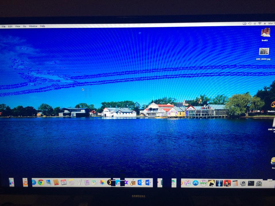

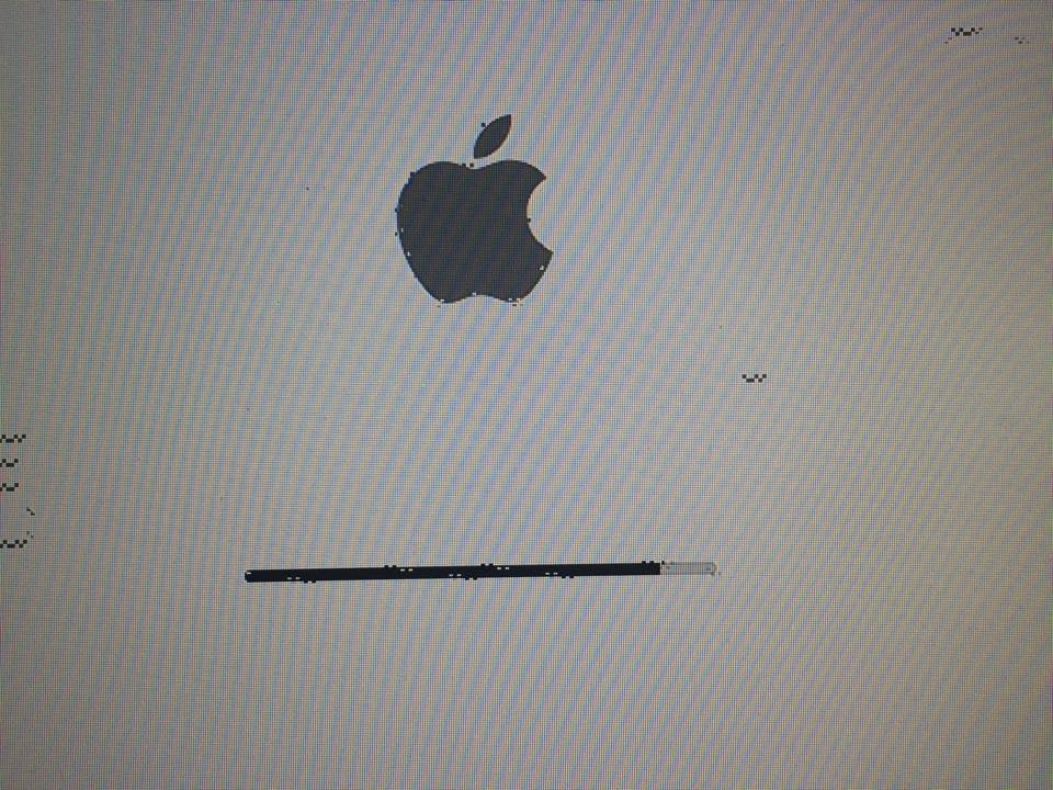

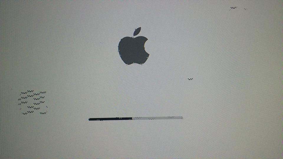

I am having issues starting up my Mac Pro. It's a 2009. Went to start it up, and this comes up.
I have tried to boot it into safe mode, it gets towards the end of loading and then fails. I wonder if its the GPU that has failed.
Any suggestions would help.
From the artifacts I see, seems like it. If you have another GPU to test, swap them, boot and check the error logs.

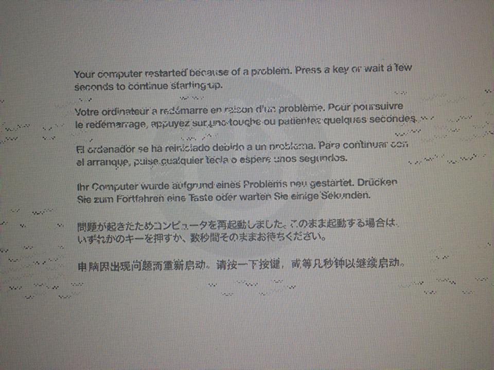

*** I got it to boot up, and this comes up, I would think it is the GPU?
If my GPU is gone, what would you all recommend as a reasonably priced GPU? I notice most new cards require a 6 to 8 pin cable.
Well it looks like I dont have to replaced it. Did the old power cord out, hold power button for 30 seconds, plugged it back in, turned on and all good. But I still want to upgrade the GPU
