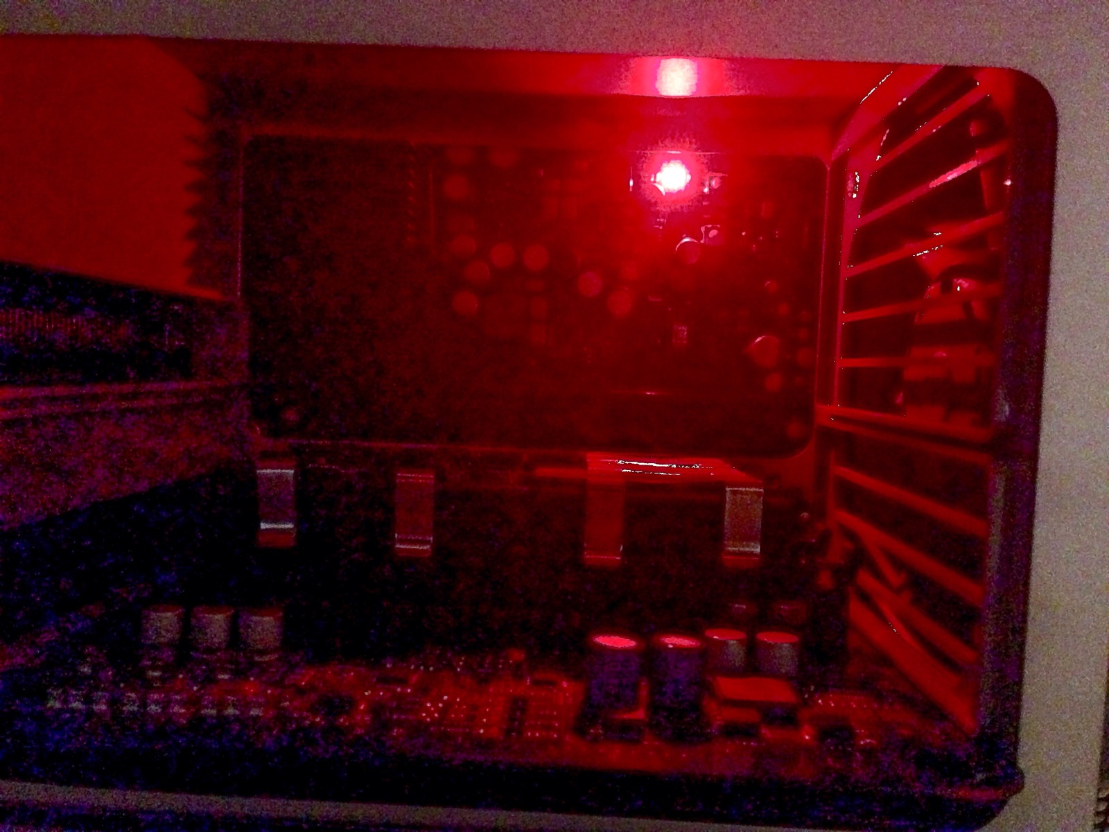

I have a Mac pro 2,1 running OS X Yosemite, also I had upgraded the graphics card to an Nvidia GTX 570 HD 2.5GB VRAM, the computer runs fine until I open any application then it shuts down, restarts twice and goes back to normal "Sometimes I have to repairr the drive to boot", I had replaced the ram with a kit purchased over E-bay "The seller claims
is compatible" the ram is recognized by the computer, on the following picture yo guys will notice a red light that remains on after it shuts dow, a friend of mine told me that a faulty Power Supply Unit maigth be the issue, what do you guys think?. Also, the memory boards from a Mac Pro 1,1 will work on a Mac Pro 2,1?.

It could be the power supply. You need to troubleshoot. First, I would take the GTX 570 out, and put your factory card in, and see if the problem still exists. If so, then you have a problem pointed at the card, or power.
If you have the same issues with the factory card, then you need to look at the ram. I would put the factory ram back in, and see if the problem still exists.

I had tested the ram, hard drive and graphics card on another Mac Pro and they work fine, at this point I think the issue might be the PSU.
With the 570 being a bit of a power hog (330 odd watts iirc) and your old PSU losing a bit of peak power over the years it would be my prime suspect tripping it out when the GPU kicks in properly.
