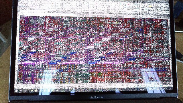

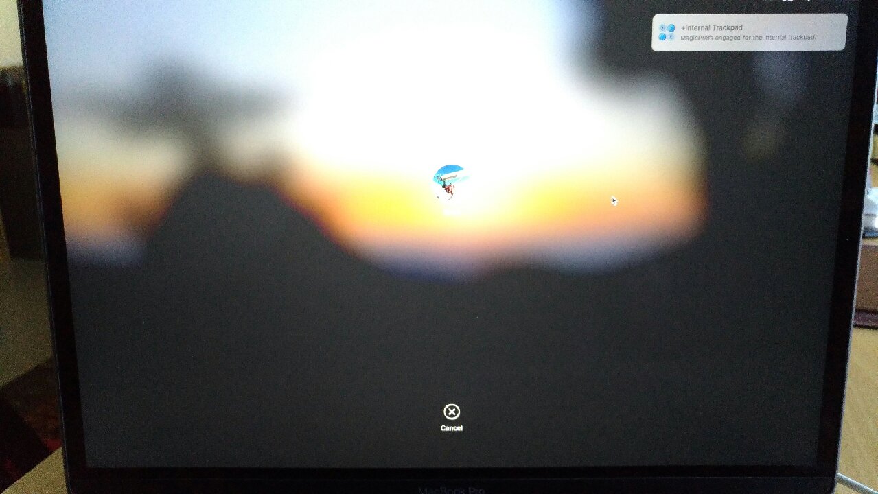

Many thanks. I've attached a couple of shots. The black (blurred) screen occurs on start up. The pixellated screen occurs at any time on any application. I don't have a shot of the black and white flashing screen that occurs before it shuts down.

Give them the shots of the glitches and they'll likely replace the logic board. You can try to talk them into replacing it, and letting you keep the one you have until they send you a new one.

This looks exactly like the bug in macOS and maybe your kex files didn't update correctly when you updated macOS.
