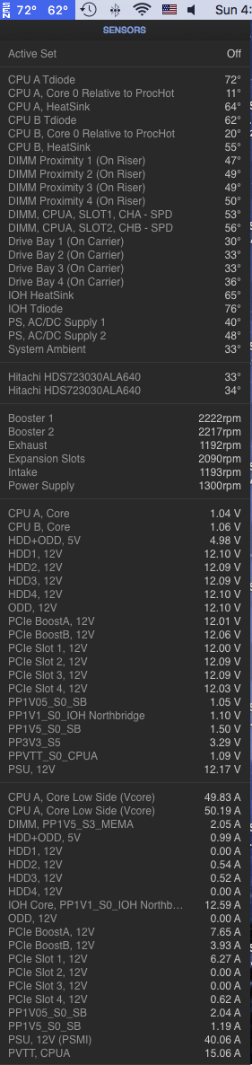

I have a 2012 Mac Pro, 12 core, with a GTX 780. When the CPU and GPU are under heavy load, the computer powers off after about 5-10 minutes. I can't power it back on until I unplug it and plug it back in. This is a new problem, my hardware configuration has not changed recently.
I've been monitoring temperatures but I don't see anything crazy high (although I don't know what high is for each of the different sensors). But when I force all fans to max RPM, the computer doesn't have a problem staying on. So I'm guessing it must be a temperature or sensor issue.
Here's a screen shot from iStat just before failure. Any ideas on how I can troubleshoot this?

Try watching how much power the graphics card is using under load. In some instances, the Mac will shut down if it is using too much power. The Furmark OpenGL benchmark is good for testing this. In iStat Menu, watch PCIe BoostA, BoostB, and PCIe Slot 1.

Your temperature looks good, however, the PCIe BoostA current is quite high. As MVC points out, if your 780 runs warmer and warmer, it will draw more and more power. If at some stage, it pull 120W from a single 6 pin, that may trigger the self protection to shut down the machine.
I am not sure if this is your problem, but you may spend some time to monitor the PCIe BoostA reading. From memory, even though the history graph shows up to 18A, but the actual reading was cap at something like 8.99A. I am not sure if this hardware limitation, or software limitation, or if this limitation still there. Anyway, if that reading keep increasing and finally stay at 8.99A, that may be the problem. The shut down protection kicks in at about 120W (10A), if that keep at 8.99A, the real loading may be 9.xA already, which is very very close to (or actually reach) the "shut down limit".
