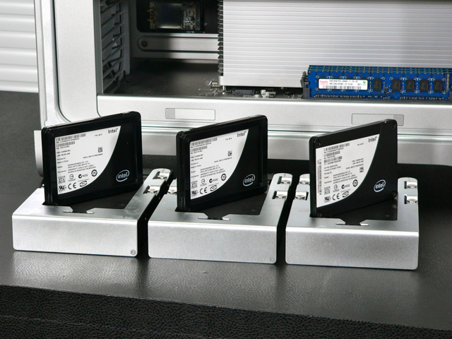

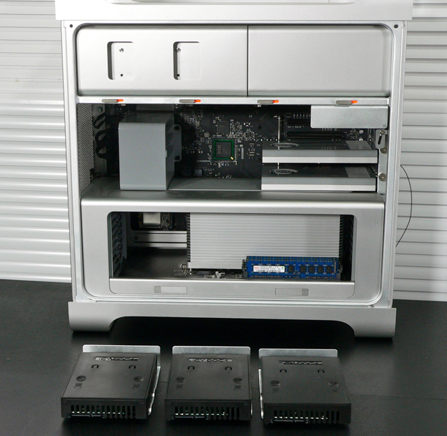

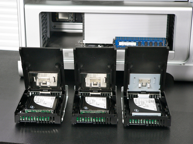

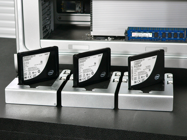

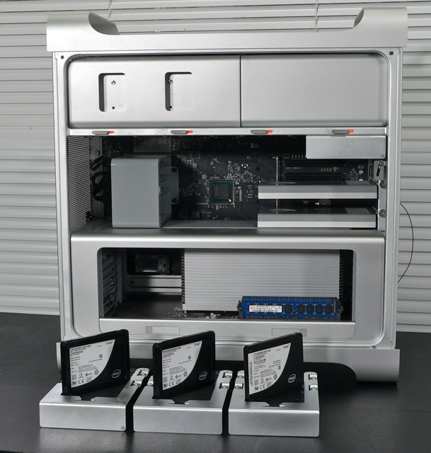

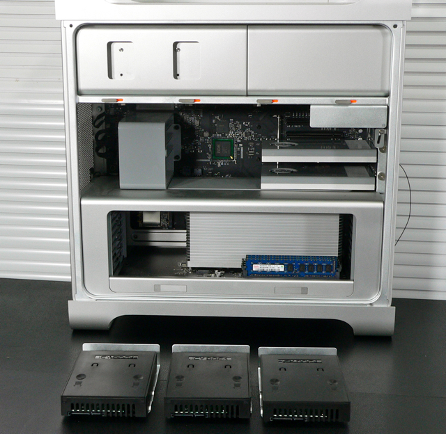

Using the Icydock enclosures makes install a breeze as you can see from the photos. The Mac Pro internals really are a work of art! 😀
