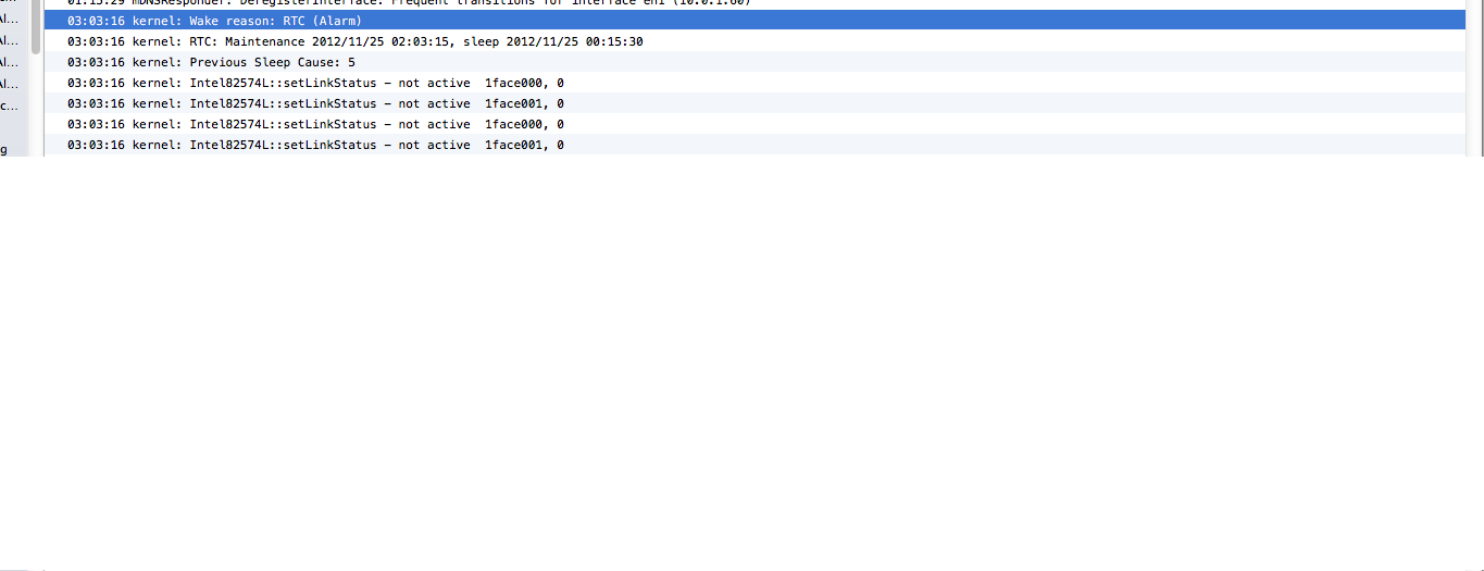

I usually shut the Mac down completely when I go to sleep because I have my bed in the same room as the Mac, but yesterday I came home wasted and totally forgt that the MP is still running. I was half-sleeping when I suddendly heard the clicking noise of the PSU folled by the fans, and then my Cinema Display lightened up the whole room. 5 secs afterwards, the whole thing went to sleep again. I got up and checked what the machine did, apparently nothing, had some apps like Firefox and console open, and also no Time Machine, so I checked the console what it reported. It said Wake Reason: Alarm (a screenshot of the console is attached).
What was that? I have this Bonjour proxy enabled, but form what I read this shouldn't activate my display when the machine wakes up. I don't have anything in my calendar, and no alarm set...

^^^It's Bonjour sleep proxy. Wake reason RTC is the key. Why it's waking up your display then? My guess will be your graphics card which is, gently speaking, non standard one. Test it with other card you have, or turn off this feature if it bothers you.
Since you have a non-Apple card, it will be waking up with the machine. My Apple 5870 stays dark when Bonjour wakes the machine up.

You guys could be actually right, because I have this issue that when only the monitor goes to sleep, it either goes blank white or keeps the desktop, but it refuses to simply turn black. That may be it.
I really didn't thought of that.. maybe because it was 4 am in the morning...
