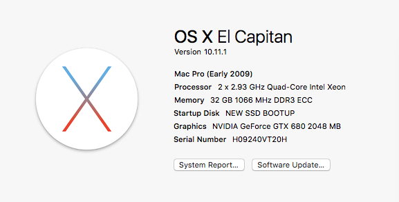

I attached a screen shot of my current card. Guess I was unfortunate enough to have gotten a DDR3 card rather than a 5 not knowing there was a difference. I originally started shopping around because I recently started to get some artifacts and adobe crashes/ but now it seems to have stopped after another El Capitan update and I started thinking about running two cards?? I'm only wanting more power for Adobe suite not games.

In the screen shot you included, the only DDR3 I see is your system memory, not the GPU's.
Adding a second video card will give you additional CUDA cores which can help with some of Adobe's apps.

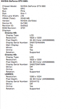

Attached is a screen shot of the card stats but I can't tell what it is from this, but I'm now assuming it is a DDR5~
