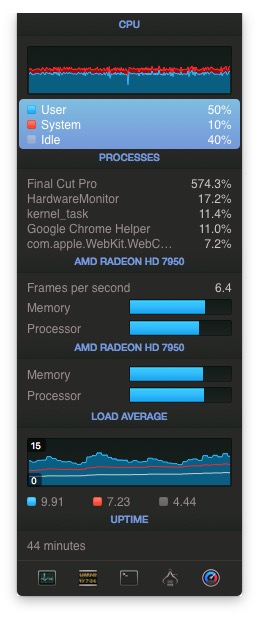

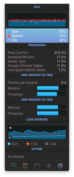

I have 2x 7950 in my 4,1 (in slot 1 and 3). Some benchmark software e.g. openCL OceanWave will only shows shows the card that in the x4 slot. But FCPX able to use both GPU very well.
Anyway, to keep it simple, connect the monitor to the card that you want to be the primary card.
