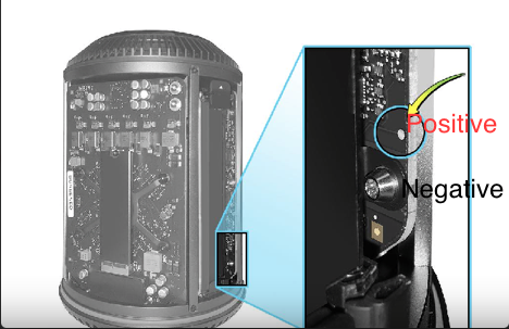

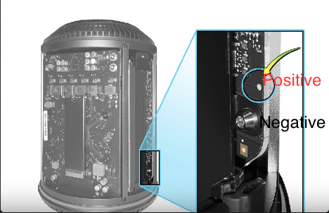

On the manual I've read about the coin cell battery check, and I will try that as I have an multimeter, I'm just not sure how, the manual indicates a test point and I assume that's where the red tester from the multimeter should go, I just don't know where to put the black tester.
Any screw nearby, see the image below, is connected to the GND plane and can be used as ground for your black multimeter tip.
