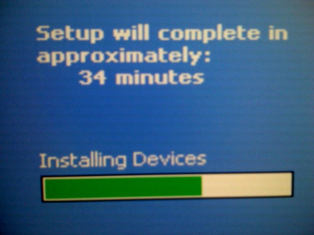

    Ok, this has me weirded out.
    I am running the new leopard boot camp assistant and I set aside an entire 250GB drive to run windows XP Pro SP2. I run the assistant, reboot, and get into the install process where it then proceeds to lock up at exactly 34 minutes remaining in the "Installing devices" section.
    - I have tried formatting both NTFS quick and normal
    - The install CD is clean and free of scratches
    - I have tried the CD in both superdrives on my MP
    - I have left the install running for over 12 hours.
    - I even tried downloading a working copy of XP Pro SP2 off bittorrent (I know...) and it freezes at the exact same spot as well.
    Absolutely nothing works. Any ideas?
  2. FatGolfer macrumors member
    Joined:
    Oct 3, 2006
    #2
    Do you have any preipherals connected (other than mouse and keyboard)? I have had problems with Windows installs when I have external drives / printers / webcams etc. connected.

  16. tuartboy thread starter macrumors 6502a
    tuartboy
    Joined:
    May 10, 2005
    #16
    Actually, I have. :)
    I have 2 Dell 2405 monitors with those all-in-one card readers on the side. As soon as I unplugged the USB cables leading to the monitors the OS installed fine. I then plugged them back in and had some problems with the OS hanging on boot and never leaving the gray screen. Again, after unplugging them everything works great.
    I also have noticed problems with my little motorola bluetooth USB adapter. I suggest if you have either of these 2 items (USB card reader, bluetooth adapter), try unplugging them and then install.
