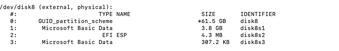

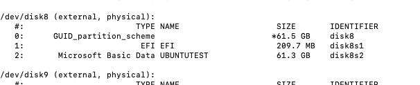

When I was dabbling with Linux on the Mac and searching for a suitable distro, I successfully used the second method that's outlined in this article to create bootable Live USB drives from the Terminal. I'd imagine that @Amethyst1's suggestions will get you over the finish line but if not, give it a go. :)
OK I tried the method you recommended but still no joy i am afraid.
I am using the latest OSX and it created the ubuntu.dmg and not the ubuntu.img but i tried both with the same result.
for your info the USB stick i am using is listed here as disk8 see image below for how it looked after the initial Erase.
and the image below is how it looked after writing the ubuntu.img file
Do these look right to you please?
thx
JohnW

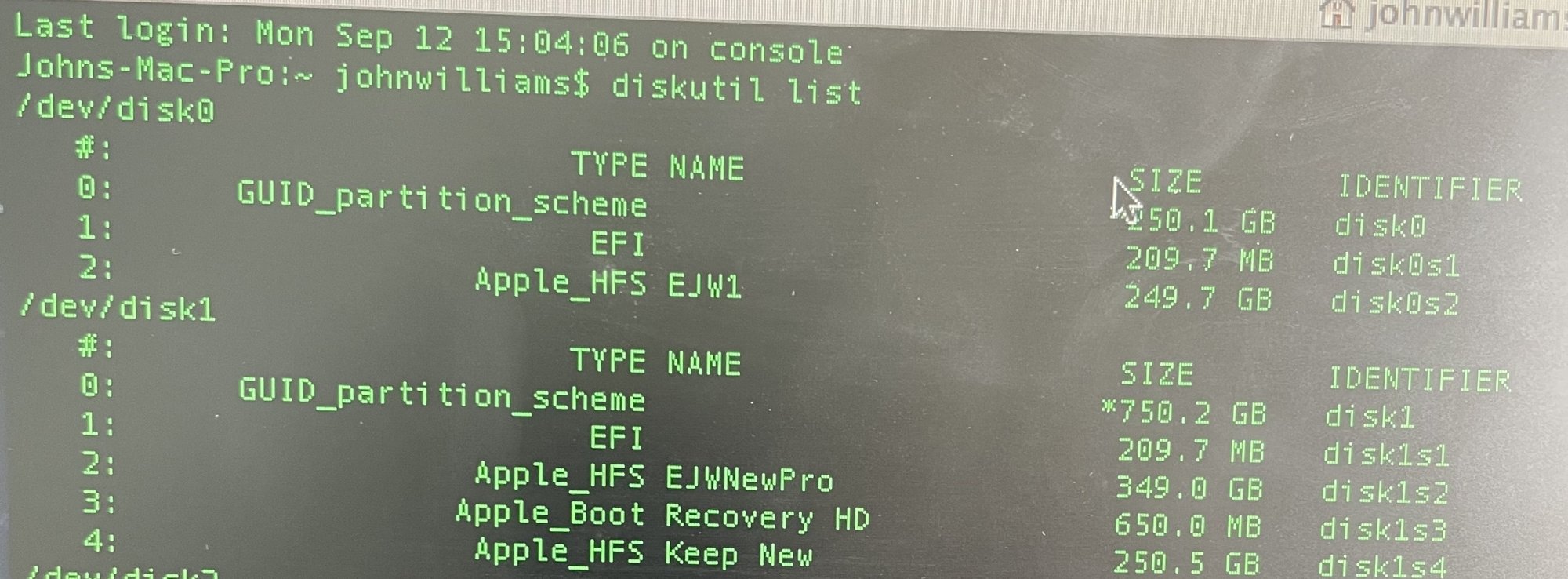

Hello,
For the uninitiated, ie me, why would I do this, please? I am trying to learn as i go on this one...
Before i hit the Post Reply button i thought i would find out what i have on the system at present, please see the image below
Both disks appear to have an EFI partition already, is this what you would expect?
In this image the disk that is the boot disk is Disk1 but since i took this i have switched the physical drives around so now the boot drive is Disk0
Thanks
JohnW
