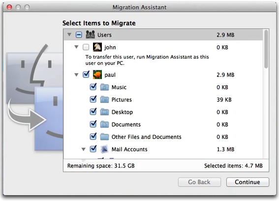

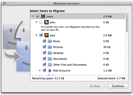

One last question! I've never restored a Mac before so I'm not sure if it works like windows. Can I restore only certain things from TM backup or does it have to be the whole thing? Specifically music. I don't really care about the rest of my stuff because I have it elsewhere, except for my music and 1Password. (Though I'm assuming if I'm backing up 1Passwird through iCloud that it'll just go back to normal by itself once I download the application, right?) Also, is there anything I should disable from settings or log out from so I don't have problems when I start my computer back up?
There are two ways to approach this.
This first is to use the TM backup to do a full restore. So you option key boot to the TM disk then erase the internal drive and click restore. That puts the OS and your user account and all your data back on the drive. There are no options... it all goes on there.
The other option is to command-r boot to recovery and erase the drive from there then reinstall the OS. At the end a setup assistant will run. From there you can "migrate" your data from the TM backup. When you do that there is some control over what comes in. You will get to screen similar to this. So you would check your user account to bring that in, but you could uncheck the Music folder if you did not want that.
This would bring in iPassword as well.
