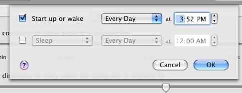

Well, that confirmed something is set....
Code:
G5:~ Scav$ pmset -g sched
Repeating power events:
  wakepoweron at 3:52PM every day
Scheduled power events:
 [0]  wakeorpoweron at 08/12/13 15:52:00 by Repeating
G5:~ Scav$
Now some googling to figure out how to solve it.
Thanks for the helps
Edit: well, that was an easy google.
I have no idea how that got set...It's maybe something I set years ago for some reason (before the above mention power supply replacement and purchase of my new iMac, I rarely powered off the G5.)
Thanks again!
