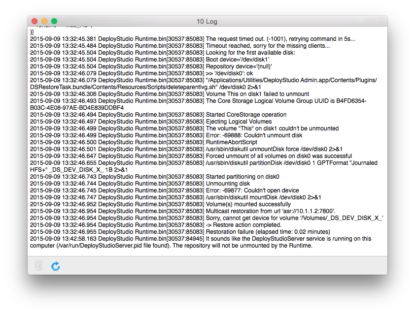

So the install/reimage process but it had an error and didn't complete. It said to check the log (on ther server machine) so I am in the log in the DeployStudio admin program. My log photo is attached.

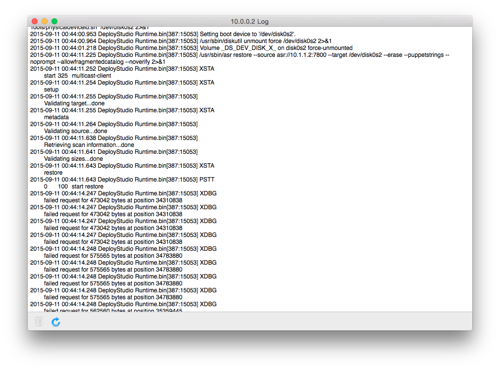

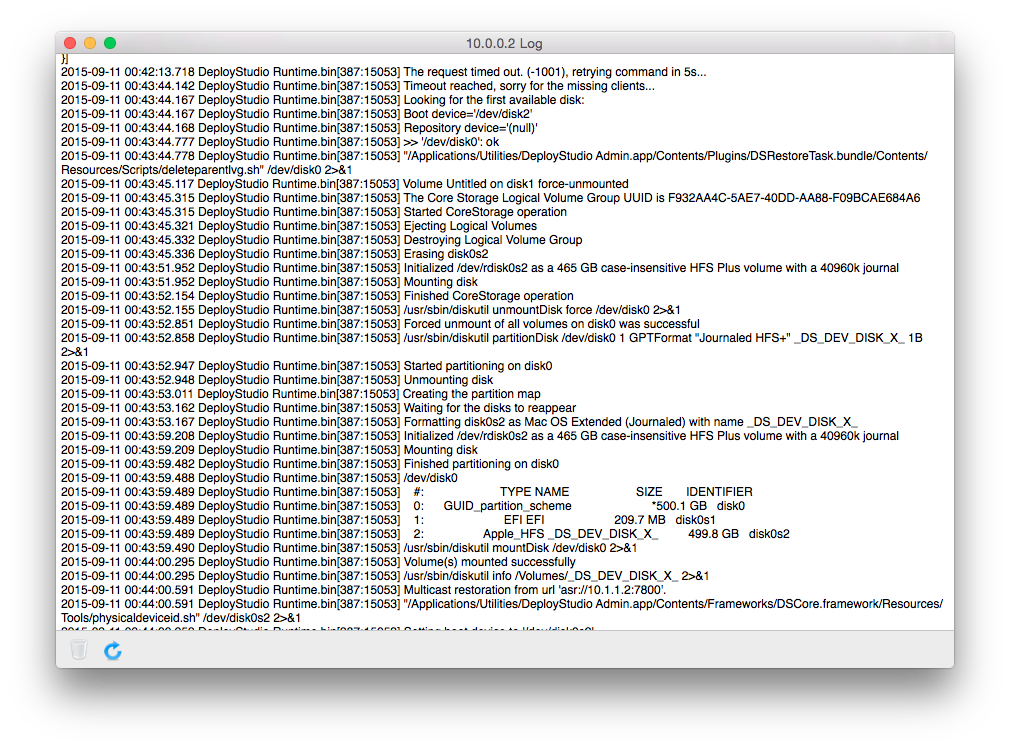

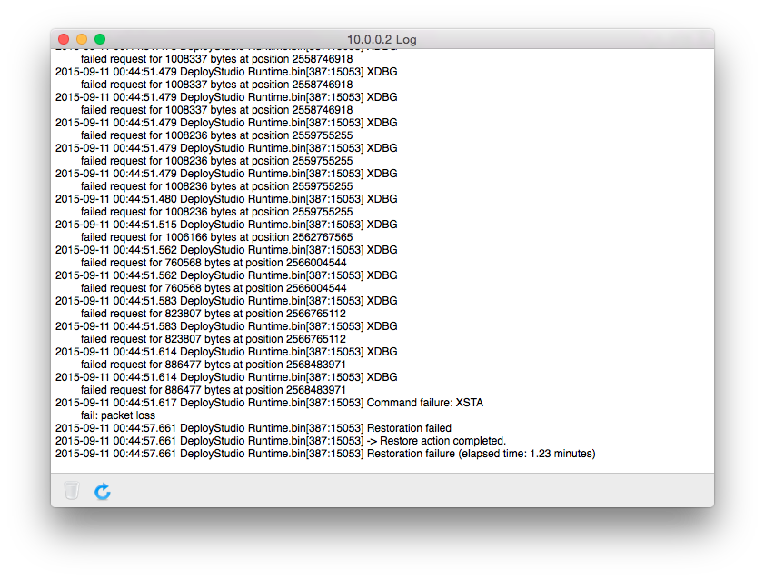

Ok so everything I did last, worked. Granted at the time I only had 1 machine to test the deploy on. But nevertheless, it worked. Reimaged/Restarted, on to the next one....However, I did this trial run on my personal machines, but I took my notes to the office, to do the EXACT same thing. Went step by step, NO room for any mismatched variables, except the actual computers I was using as the 'admin' and the 'blueprint'. Same model of Macbook Pro.
When I boot up even just one computer into the DeployStudio Netboot, it gets to the Deploy Admin screen where I select my custom workflow (which is just a restore with multicasting, skip recovery, automate.
I get a long list of log error (which I will attach below) and it ends up failing, and the machine ultimately restarts to a blinking question mark white screen. So I at least know it's 'wiping' the hard drive in the process, but not reimaging the machine(s).
Can someone give me a solid idea as to why (if I used the same guide in my setup) it would have log errors and fail with the only variable being, different computers for the 'admin' & 'blueprint'. I beat my head against the wall for nearly 10 hours today, and 30 over the weekend. I am needing some good veteran/pro help!
Thanks in advanced guys :)
PS, there is much missing in the screenshots between image 3 and image 4. It was all the same-ish log, so I didn't include it because you can see some of it in both 3 and 4.

Looks to me like you might need to adjust your multicast settings (disk speed and network speed) in the DS workflow. I know when I do a multicast restore I see the same errors, but somehow it usually works. It's just highly dependent on those settings. You might also check your switch's options assuming it's a managed switch.
Failing that, try turning off multicast and see if it is successful with unicast. That will help you narrow it down.
Sounds like you've otherwise done things right...

I did use the multicast, however I did not adjust the parameter stuff.
This network doesn't see any other activity beyond deployment/reimaging. I use a D link 24 port switch. I am kinda new to this deployment stuff. Any further insight on this?
I'd start by dragging the sliders down to maybe half their current setting and see what happens. If it's successful, you can try moving them upward in small increments until you start having problems again. As you experiment you'll kind of get a sense of your sweet spot.
Otherwise, like I said, it looks like you're doing everything right. :)

I didn't move them at all from their preset values that became enabled, as I enabled the multicast. So even the low settings they are at by default, are too high?

To your first post: I forget what the default settings actually are. In my environment I've had success with a stream data rate of 30MBs and client disk speed of 125MBs. That's coming from an Xserve with dual bonded GigE to MacBook Airs with Thunderbolt to Ethernet adapters.
As far as creating the DS Netboot set, I've always done it directly on the server. You shouldn't need to do Target Disk Mode at all. That said, I'm not sure that it matters... I think it just needs a valid and complete OS X Install to steal files from. That said, make sure you're creating the DS Netboot with the newest version of OS X you use to avoid any issues booting different Mac models.
