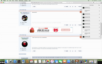

I was just looking at a news site when my iMac (mid 2009, running El Capitan) suddenly started behaving strangely. Everywhere I clicked a large gray Safari emblem appeared on the page, and I got a message saying my Mac is infected, and to call 888-342-4947. It also said that if I left the page the Mac would be permanently damaged. I figured it was a spoof, but the Mac was downloading files. It wouldn't shut it down, so I hit the on/off button and powered down. When I rebooted, the Mac was still downloading files, so I tried to force quit Safari, and got a message saying it has 11 more files to download. I had it force quit anyway.
Now, how do I get rid of and files it already downloaded, and make sure they don't open? I'm worried
Thanks.
Edited to say: OK, I figured out how to do a screenshot. It's in the next post.
[doublepost=1556224313][/doublepost]Here it is.

I'm looking for users and downloads in Finder but not seeing it.
OK, I found them. Now how do I delete them? There's a huge number of them!

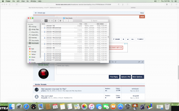

I see downloads, and when I click on the little gear at the top, the option to delete them is not there. A lot of them are grayed out.
This is what it looks like.
[doublepost=1556225925][/doublepost]OK, I'm moving them to the trash folder one at a time.

Will do. there are hundreds of them in there.
[doublepost=1556226361][/doublepost]OK, I accidentally deleted files I needed. There were over 1200 in there. Guess I can take the ones I need out of the trash.
