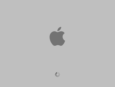

[…]when I tried to turn it back on there was only a grey screen with the Apple symbol and a loading wheel below it.[…]
Are you talking of this screen?
If yes that should be totally normal...
I am aware that that is completely normal, however the loading screen has stayed that way for about four hours with no completion.
